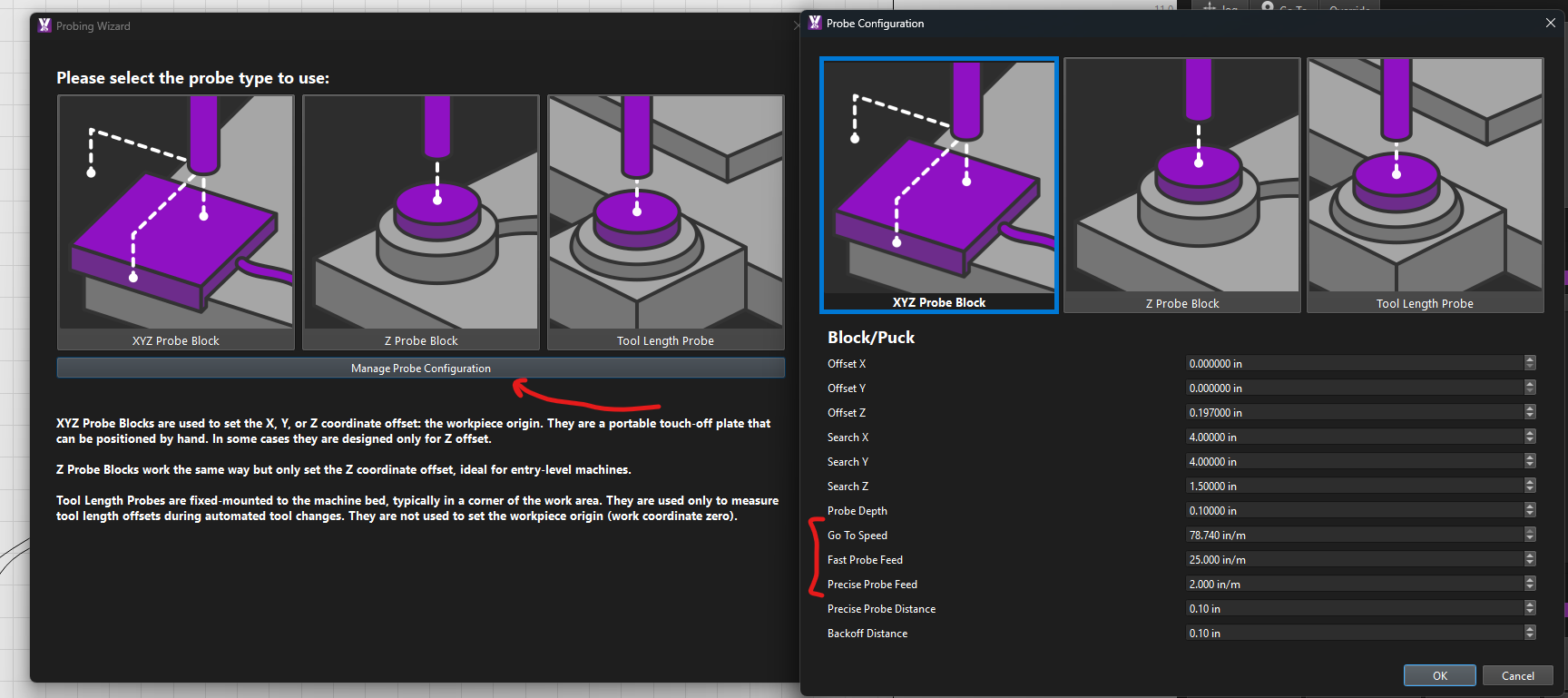

If I understand correctly, you’re getting the Err22 when performing a Z probe with the probing wizard?
Can you open up the probing dialogue, then select ‘Manage Probe Configuration’ and check that you have speeds set in the three boxes near the bottom?
I was getting Error 22 anytime I tried to jog the Z azis. I didn’t have to be probing.
