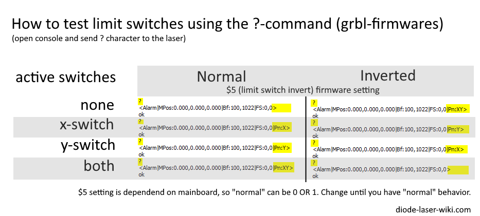

It seems there is an issue with the limit switches. Check them using the question mark command (explanation here: Limit Switches - Diode Laser Wiki ). I guess the electrical connection might be loose or faulty.

The explanation is in the linked article. In short:
It does work for grbl firmwares. The messages you reported above look like a grbl variant, at least.

Now I feel really dumb. When you say open the concole and send a ? tothe laser. I dont know where to find that
MikeyH
(Mike Hembrey)
January 14, 2026, 7:23pm
11
Console tab on the right side, then enter ? in the text box and hit Return. The Console window should list the results if your controller supports it.

So Idid just the ? and it responded with; ?
<Alarm|MPos:-10.000,-10.000,0.000|Bf:199,512|FS:0,0|Pn:Y|Ov:100,100,100>
ok
MikeyH
(Mike Hembrey)
January 15, 2026, 3:09am
15
interlocknz:
Pn:Y
The Yaxis switch is closed . Was it sitting on that switch when you did the command? If not, you found an issue.
If you just Homed the machine, it should not be sitting on any switch.
