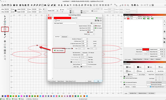

> **[error LB 2.1.01.mp4](https://drive.google.com/file/d/1zVT5DHOWt9a1LImo1hjwkl2TFL6NLVnz/view?usp=sharing)**
> Google Drive file.
<div class="post-metadata">
**Author:** ![Rick](https://forum.lightburnsoftware.com/user_avatar/forum.lightburnsoftware.com/rick/32/69_2.png) [@Rick](https://forum.lightburnsoftware.com/u/Rick)\
**Post date:** [May 27, 2026, 8:15pm UTC](https://forum.lightburnsoftware.com/t/error-en-agregar-pestanas-v-2-1-0-1-error-adding-tabs/190151/2 "2026-05-27T20:15:14Z")
</div>

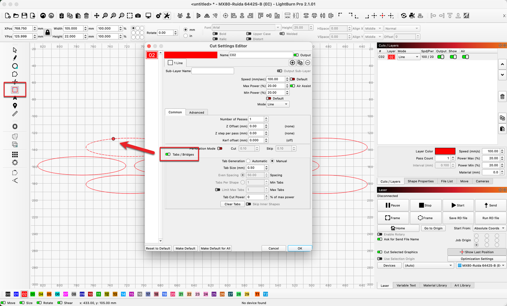

Thank you for reporting. We will take a deeper look. For now, enable (flip switch to green) the ‘Tabs / Bridges’ setting in the ‘Cut Setting Editor’ to use the Tab placement tool.
 ![image](https://forum.lightburnsoftware.com/uploads/default/original/3X/2/a/2a108e0a99836c6bd1f1d48d32b2d0d3e3df0c91.jpeg)

Reproduced locally… looking at it.
**Author:** ![adammhaile](https://forum.lightburnsoftware.com/user_avatar/forum.lightburnsoftware.com/adammhaile/32/33797_2.png) [@adammhaile](https://forum.lightburnsoftware.com/u/adammhaile)\
**Post date:** [May 27, 2026, 9:22pm UTC](https://forum.lightburnsoftware.com/t/error-en-agregar-pestanas-v-2-1-0-1-error-adding-tabs/190151/4 "2026-05-27T21:22:54Z")
</div>
This will be fixed in v2.1.02 (probably next week). It just wasn’t enabling tabs on that cut automatically. You can still enable them manually to see them.
