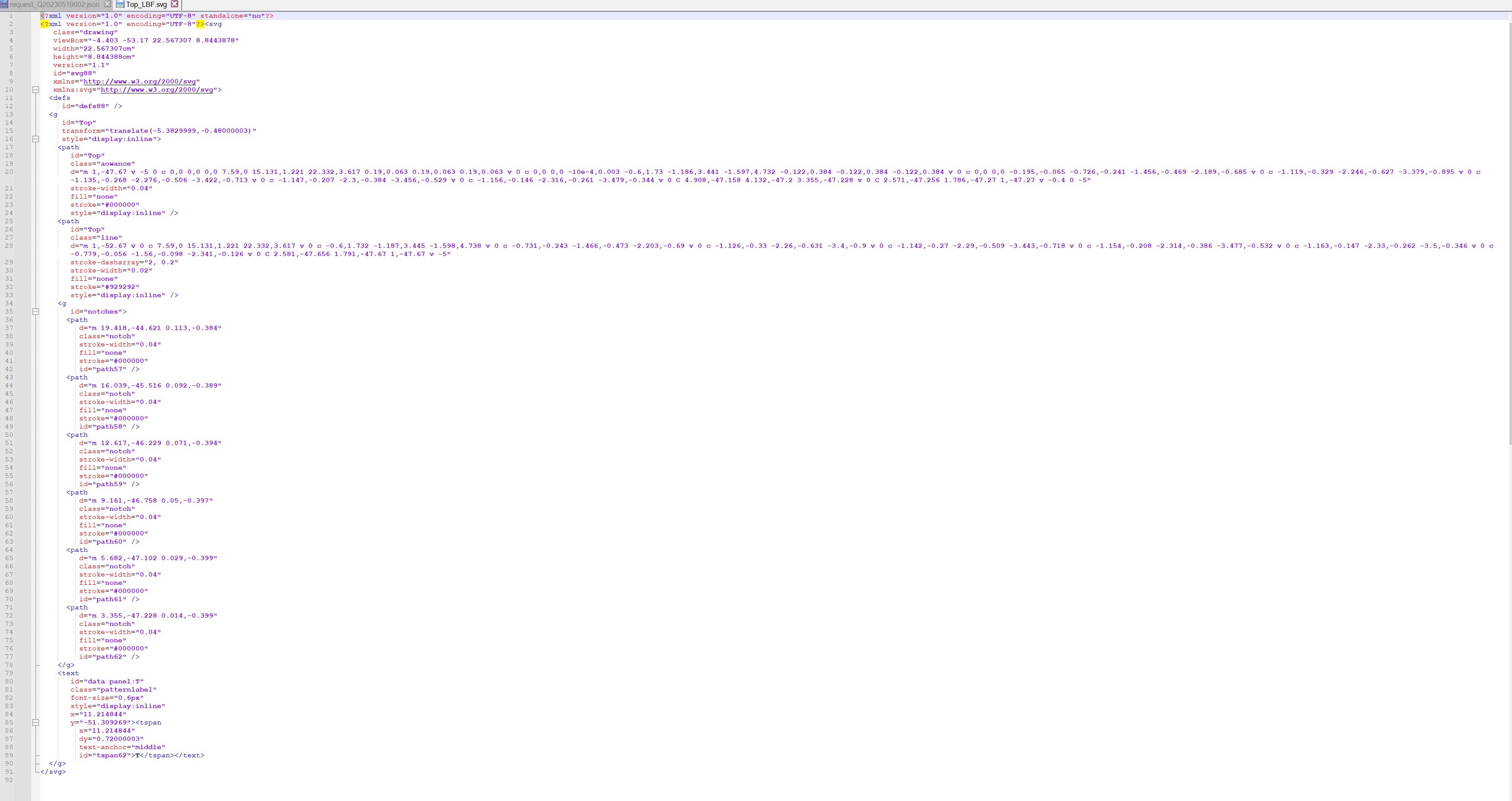

If that’s the case can you open your svg in a text editor and paste a screenshot here?
it’s an online pattern creation platform ( for clothes making). I’ve just noticed that when trying to open in a browser, I’m getting the same error.
If there’s no simple answer to get this opening in Lightburn, I’ll close this thread as I’m not expecting support on a file that’s clearly not to spec for a variety of programs, strange what Inkscape opens it ok !
I’ll go back to the platform and ask them what’s going on…
Screenshot attached. I’ve just noticed that Notepad++ is highlighting something on line 2. I’m used to editing XMLs ( ones I know a lot about), SVGs I know nothing.
That’s great, thanks for that. It definitely looks like an svg file. I forgot that you said you could open it in Inkscape. Can you try appending a .txt extension and attempting to attach it again?
In Notepad, delete the characters on line 2 highlighted below and save.

Did you remove only the highlighted part? If you accidentally removed the <svg part, it might fail.
Actually, I would even suggest to remove everything up to the <svg part (ie. keep this part).
