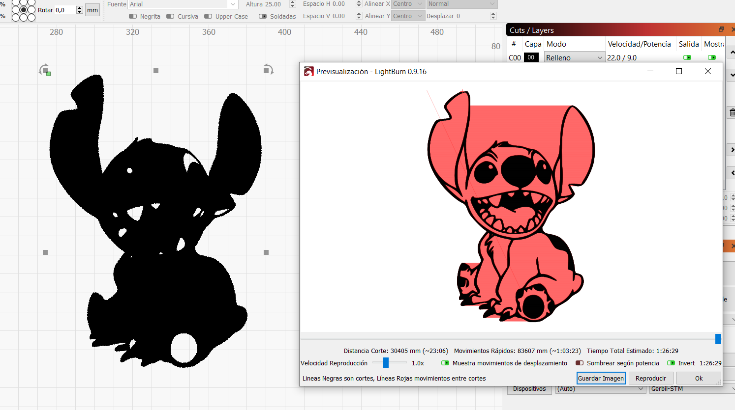

Since the update on the main screen, when you select a fill in a svg (I’ve tried several), the fill appears wrong, but if you preview it, it runs well and the job runs correctly. Why is it ?, I attach 2 models and their two preliminary views.
In the window option I have selected to see “Fill / Smooth” as always but in any of the other options it does not work as it used to…

@Forsito - I’ve figured out the problem and yes, it does the same thing for me.
The issue is that your designs have paths that are not closed. For the Stitch graphic, that can easily be fixed by selecting it and going to Edit > Close Path
The other graphic is a little more complicated to fix but it is possible.
We changed the way we render filled shapes a little while ago to better indicate if a shape is properly closed or not but the cut builder works a little differently and cares less if the shape is actually closed.

Ajam, but how is it that in an old version it is shown well and in the new one not?
Because we changed how it renders in the new version. The old version didn’t care if the shape was properly closed but the new version does. This is by design as unclosed shapes can cause other issues.
