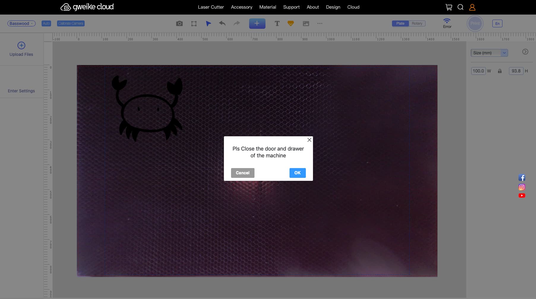

Hi I have the Error for my brand new never used before qweike cloud pro
error pls close the door and drawer of the machine
Ive tried making sure draw and door activated for close and still no hope after hours of frustration.
Any help appreciated

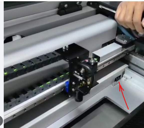

Sounds like maybe switches are not plugged in or bad connection.
how do I find where the connections are?
Make sure there is no wood scrap or debris caught in behind the waste drawer.
where do I locate the waste draw?
Sorry I think they call it the “Honeycomb Tray” or “work tray”
There should be a contact switch near the rear right on the bottom. It is shown above- photo courtesy of @keith2022
