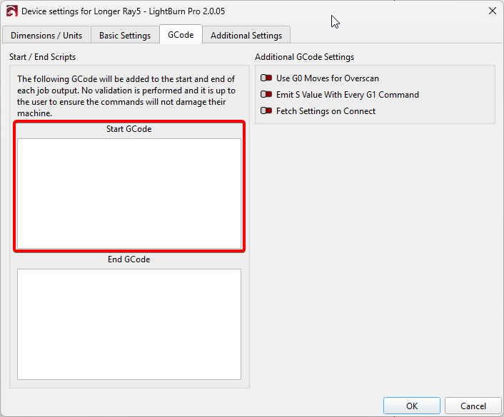

Executing home command when pressing start on a cut, MACRO?
Hi!
Question
I have a Crealitry Falcon2 Pro
Can I some how allways when pressing start on a cut, get the program to run a Hom4e Co0mmand to to my cutter ?
Ah Usally move my cutter head when working in the cutter tray, adding and or removeing materia and small pices?
hi Stewe
You could use the Grbl Start GCode commands
Laser Tools > Device settings
The command set there will always be sent as the head of the Gcode on both stream or Saved Gcode.
Rather than re-Home my machine for every run, I do not move the laser by hand. I have created a Macro that moves it to a handy location. For example, I use something like G0 X380 Y385 and name it “Retract” to move it to out of the way in a back corner.
