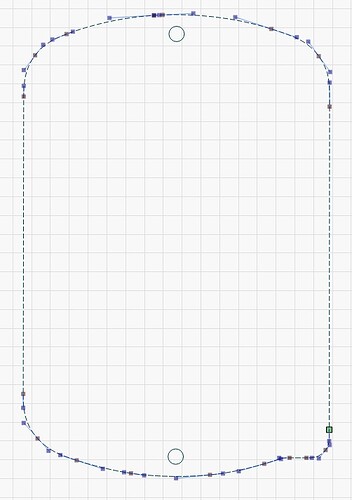

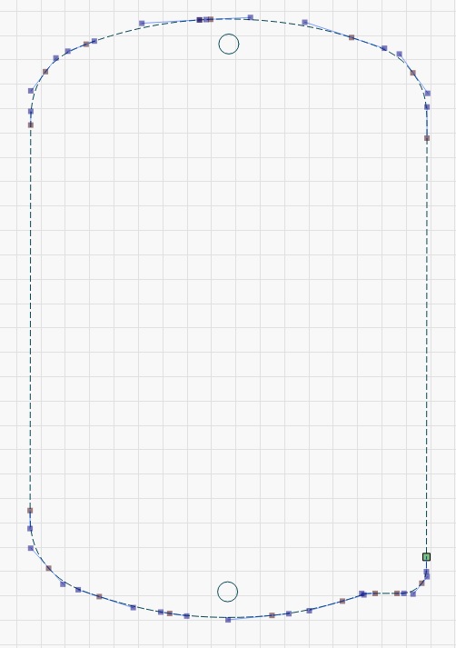

I created a file and I exported as SVG and the points were fine. I exported as DXF and it created a million points on the curve.
I do like that Lightburn actually can export as DXF without breaking every point and with maintaining the same size but it would be nice if it didn’t create a million points.
Can you try changing this setting:
Edit->Settings->File Settings->DXF Export Settings->Export Arcs
