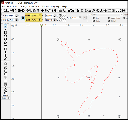

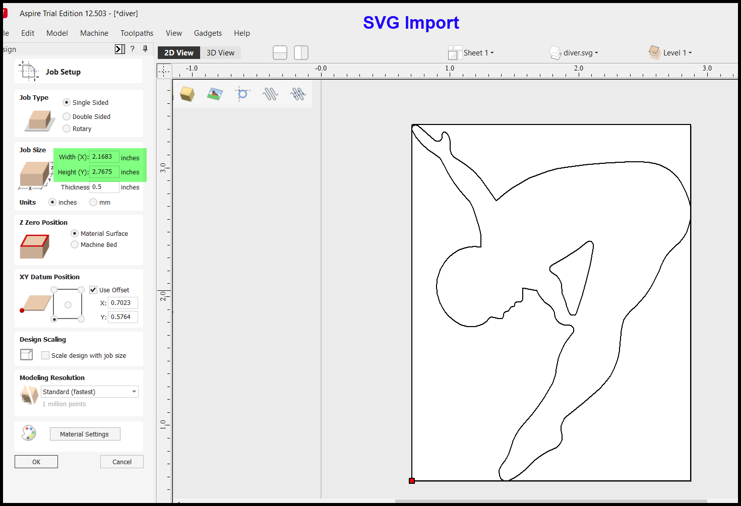

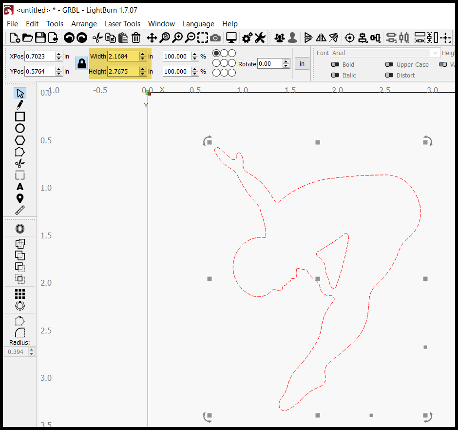

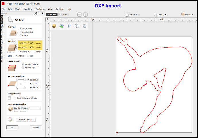

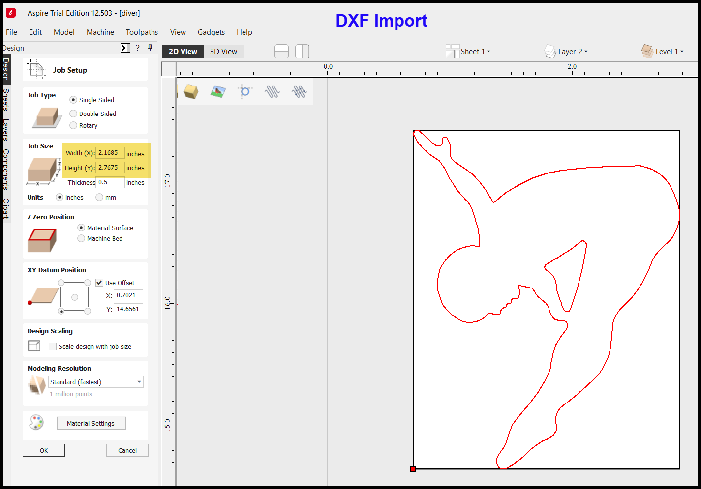

So I am trying to send to my dxf to be printed , I have been told that “aspire” is the program they are using to cut with the cnc, but it seems the dxf does not show up in aspire… how to fix this issue?
Aspire is a Vectric 3D software. I think you have a workflow issue. Why are you trying to export a laser file for use in a CNC milling operation?
I just downloaded the Aspire Trial Edition, and it opens a LB DXF export just fine. You can also export SVG from LB and import it into Aspire.
