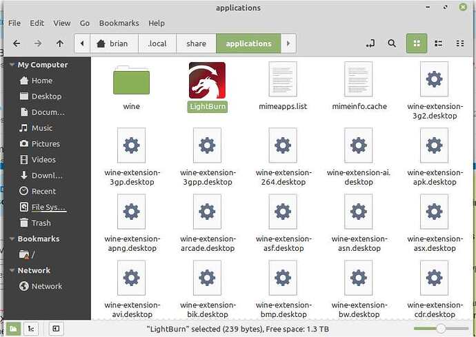

I’ve gone through the process in full from the official installation page, and it’s still not working. [Installation & Setup - LightBurn Software Documentation](https://docs.lightburnsoftware.com/Installation.html#linux-installation)
 ![lightburn-terminal](https://forum.lightburnsoftware.com/uploads/default/original/3X/9/e/9ef60821cdecb6bbf1a5cfa6d8bf3bb2e9a0d2f3.jpeg)
That was an attempt at the .run file, terminal looks like it went, but nothing to actually start it from.
I then navigate to the folder it’s referencing, set it to be trusted, icon shows, but nothing happens when I double click it.
 ![lightburn-terminal-2](https://forum.lightburnsoftware.com/uploads/default/original/3X/6/6/66ec34a64b23a30e21b90cfca0178d8c0c2e92e4.jpeg)

What version and Edition of Linux Mint are you using?
I’ll try installing this to see how it behaves. I suspect whatever desktop environment you’re using doesn’t use the .desktop convention for launch icons.

Okay. Here’s what I think is going on.
Linux Mint uses GLIBC\_2.27. LightBurn requires GLIBC\_2.29. libc is a very fundamental component of the system so there’s not a very safe way of simply updating this in place.
Your best option is to upgrade to the latest Mint if that’s possible for you. That should bring up to parity against the same version of Ubuntu that LightBurn is compiled for.
If for some reason upgrading is extremely difficult or otherwise not an option, you could try to compile a completely separate entire libc and companion libraries and utilities and try to use that for LightBurn. I wouldn’t recommend this if you’re not comfortable doing this or maintaining such a system as you’d not be responsible for keeping this current.
[EDIT]
One correction. Linux Mint 21.1 looks like it’s built on Ubuntu 22.04. That would put you ahead of the build system which is based on 20.04. 22.04 also works but if you want the least chance of possible incompatibilities then I’d suggest sticking with a Ubuntu 20.04 based Mint. The highest version looks like Mint 20.3.
For the record, I tested this on a Linux Mint 21.1 installation and LightBurn came up without incident using the .run .desktop icon.

Thank you so much! It’s going to be needing a new ISO to burn and new install all together to upgrade it appears. I’ll start with getting it ran with a dual boot on the Windows laptop with the latest version of Mint and see if it’s stable and then decide if I want to go for it with my main workstation or stick with that or the just settle with 20.3 after seeing what the lap top does. My daily driver/box files are extensive and critical and nothing I take lightly so don’t want to risk losing anything, and I’ll see if it’s doable to have dual partitions on it, both mint old and new as well.
I would never have figured out remotely where to start from with out your help, thank you so much! I’ll chime in to let you know how it went.
