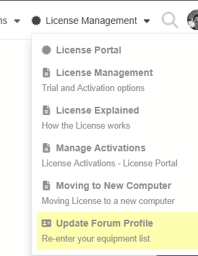

This link will bring you to the Welcome Wizard, where you can add the info that we see in your profile:
