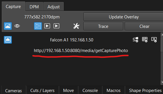

It appears others are using the camera on a Falcon A1 Pro, but I can’t get mine to connect. I have installed the dev file, but I don’t know what settings to use. Suggestions please!
Search the forum, there is a long thread discussing this matter. From what I remember, you need to use the 2.1 pre-release version of LB, since only that one supports IP cameras.
and if you download 2.1 lightburn and do the camera connection wizard the IP should be something close to what mine shows. you can find out by going to the screen on the a1 pro itself and clicking on wifi.
Mine is not showing the camera right now because its engraving currently. It wont show while working but will when its not running
Thanks much Version 2.1 solved the problem. It is listed as a Release Candidate and isn’t currently released. It worked great to handle the Falcon A1 Pro camera. What a relief.
