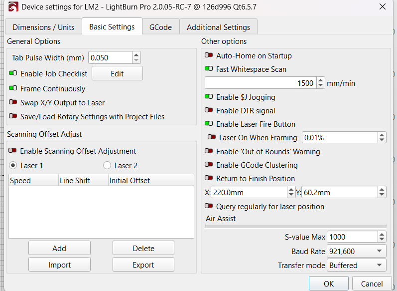

Fast whitespace scan /rapid moves

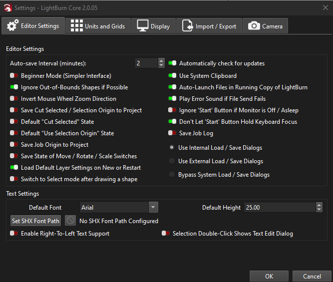

Using the latest ver I cant seem to locate either “White space scan” or Rapid moves” on account it should be under device settings. I am wondering if I firstly need to turn on other for this to become visible.
It’s still there for me on my GRBL laser
Not in my up to date ver of lightburn it has something to do with g code and digital signal processing (DSP) still working through it but it would seem that some laser controllers lock availability of whitespace scan away to protect the machine from developing backlash. that said on account this does not apply to my laser . so some what confusing
David is showing the setting in the DEvice Settings Menu. You are showing the Settings Menu. They are not the same thing. Go to Device Settings Menu (Wrench & Screwdriver Icon) Basic Settings Tab.
