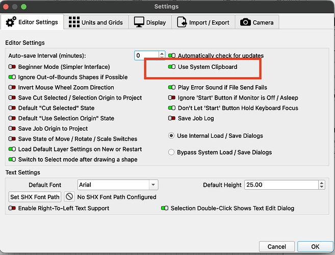

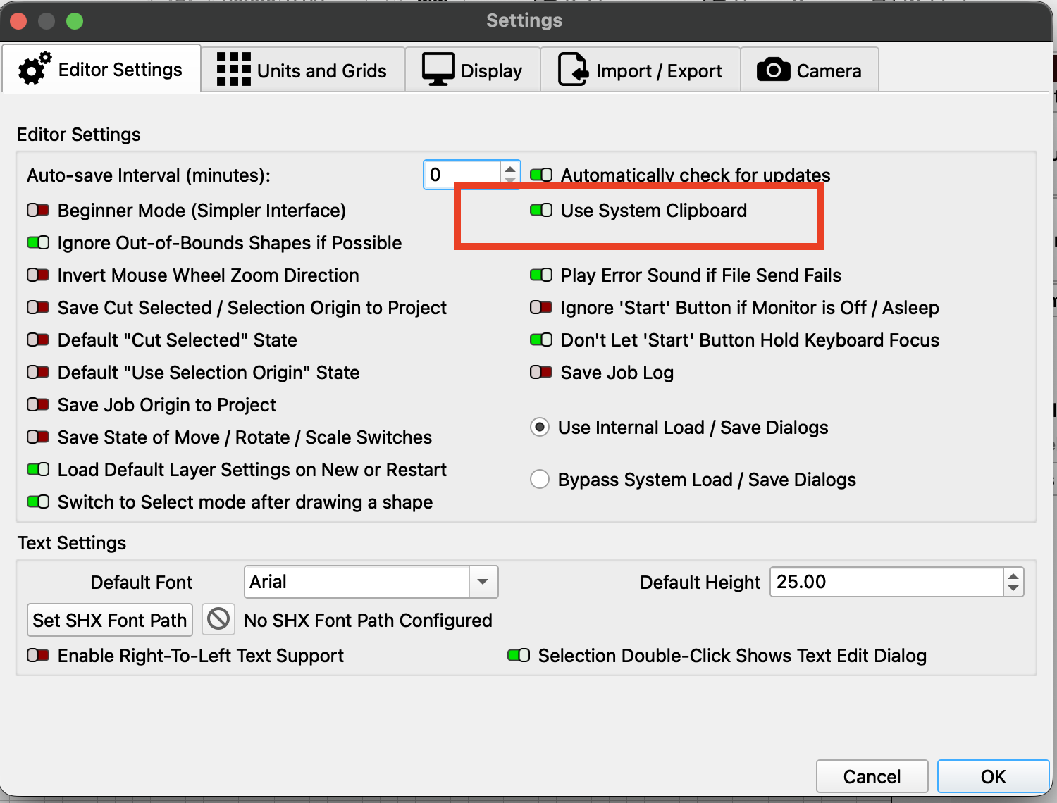

Do you have this switch enabled?
Try creating a grid of boxes the necessary size, Place the array on a tool layer, then using alignment tools center each item within the boxes. When you have everything positioned you can delete the tool layer if desired.
I realize this isn’t automated and you have to move each item individually, but it should give the desired results.
