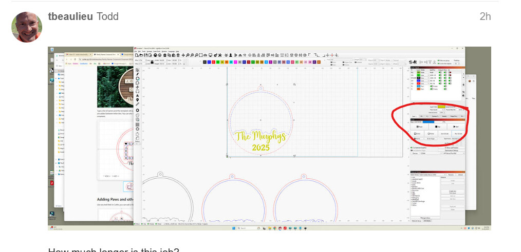

How much longer is this job?
I’m aware that the team don’t like the idea of anything that means you are not next to your laser.
And the progress bar is not available on all controllers I believe. Ruida does not give this info.
However, a time started and a whole time of job would be very useful for planning my days work.
At the moment I do an Alt-P, note the start and job length manually when I remember.

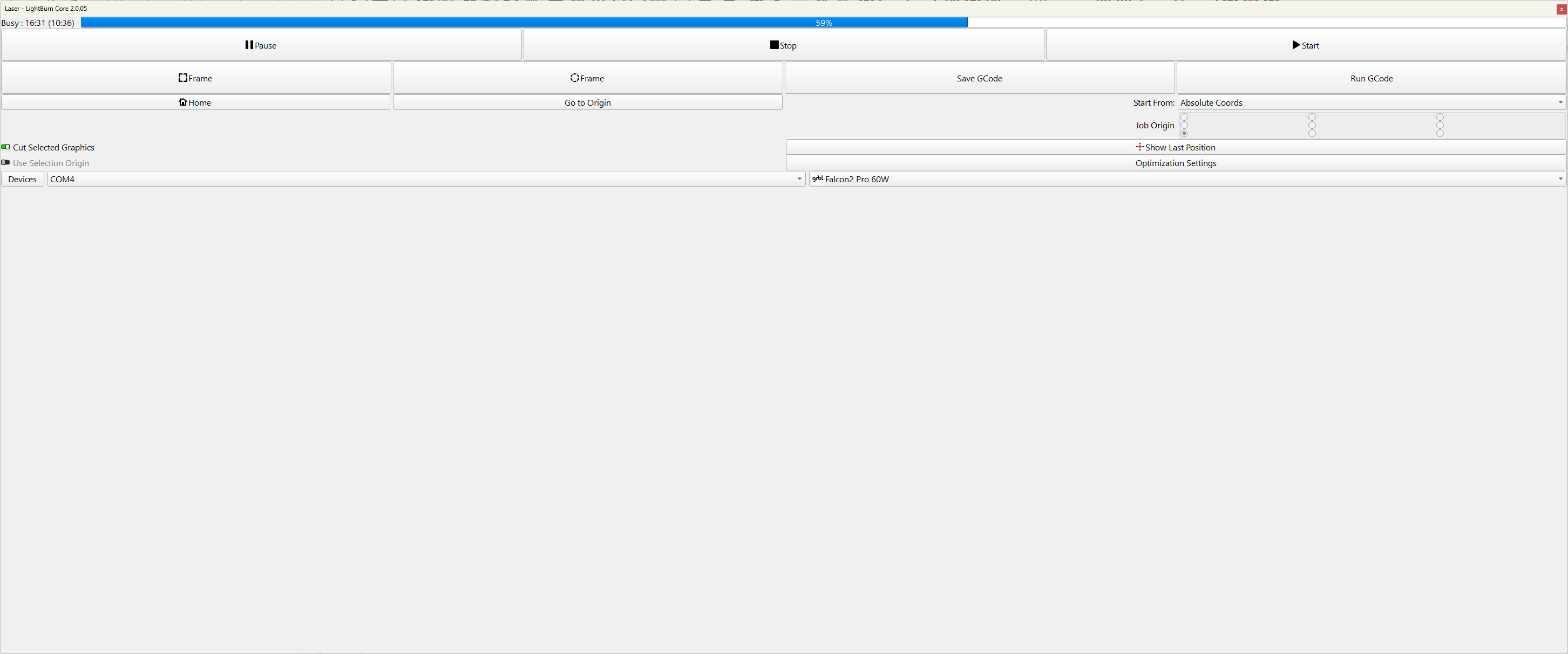

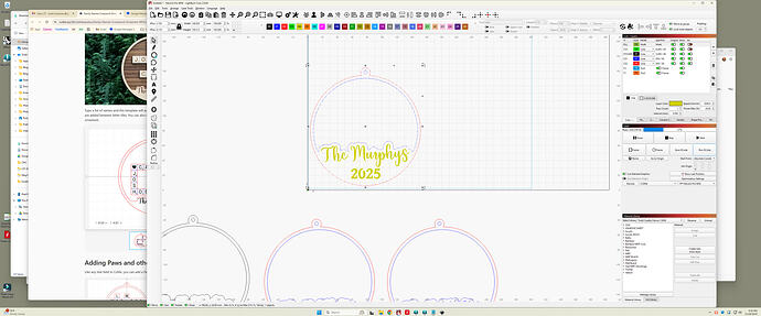

My complaint is that it takes me forever to get my eyes to locate it when checking in. It’s literally the most important information during a burn, while also literally the smallest panel on the screen. I’d love to be able to make much larger during runs. My screenshot was meant to point out how incredibly small and buried it is on a large screen.
Why not un-dock the laser window and make the window itself lager? During the engrave process, you don’t need the work space window on top of the stack. Make the whole monitor the window for the laser tab?
i.e.
I actually spent somewhere between 3 and 5 seconds seeing if could move the time field. Did not occur to me to do as you suggest. I will try that. Thank you.
Short term fix while your request is reviewed.
I have been using this undocked approach for the past few days. It’s definitely better for me. The timer is still WAY TOO SMALL in my humble opinion. I’d love to have a large, digital countdown timer that dominates my LB work session during job runs.
