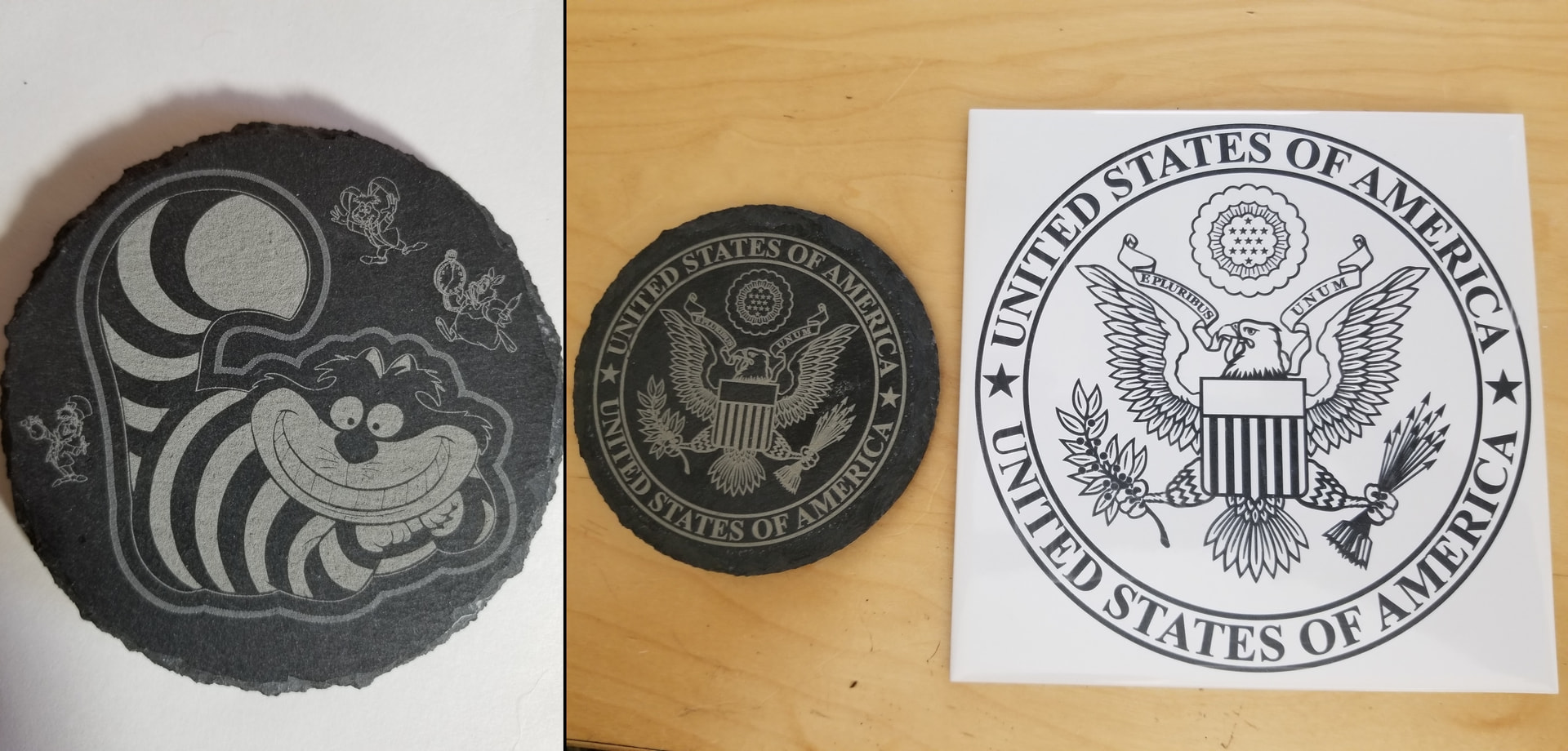

I’ve done deep coins along with co2 laser tubes, done on the fiber.
This is for my co2, done with fiber.
This is done on a pair of 4” slate coasters and a 6” porcelain tile using LBT100 coating.

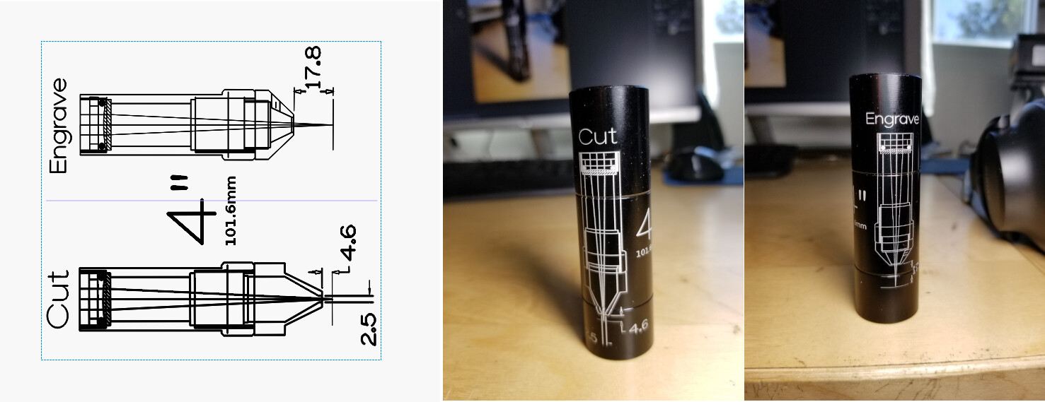

My suggestion for general use.
F420mm lens, gives you 300x300 coverage. An 800mm tower is needed to get the height for this coverage. It also allows for a rotary to be used on a longer lens.

Shorter lenses can be had as needed. The difference in lenses is noticed more as the wavelength of the lases emf changes.
It’s much more simple to use one of the on-line calculators, such as this one to compute spot size and depth of focus (dof).
If you check the spot size of an F254mm lens (spot size of ~30 microns (0.030mm) and an F100mm lens (spot size of about ~15mm). Going from the F254mm to an F100mm, the spot size is 1/2 that of the F254mm lens, so the area has decreased by 4 times. This appears as more powerful, but the source only puts out so much and the same power over 1/4 the area, it appears more power. Same thing happens to any lens, we just don’t commonly see a spot change of that size with a co2.
I almost always use my F254mm lens. Not as small of a spot as the F100mm and a much greater dof. The other issue with short lenses, when you get the ventilation and any other accoutrements, such as air assist, you can’t get your hands in there to work or look at the item when where it will be lased.

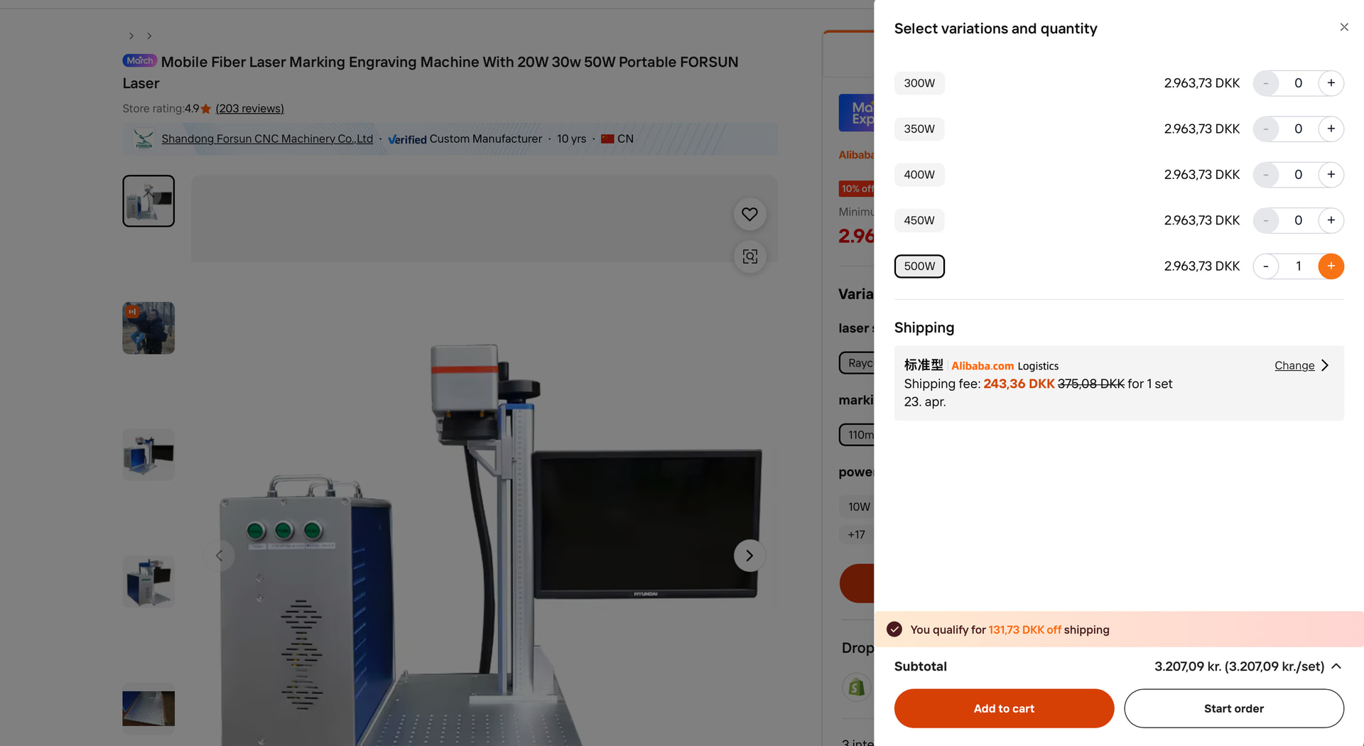

Check the prices for this one also:
https://www.alibaba.com/product-detail/Mobile-Fiber-Laser-Marking-Engraving-Machine_10000035747130.html?spm=a2700.prosearch.normal_offer.d_image.739067afYfQ3Bx&selectedCarrierCode=SEMI_MANAGED_STANDARD%40%40STANDARD&priceId=b22c3eacd1e945068954933c738efef6
VERY interesting!
  1. 10w to 130w, same $450 price.
  2. $2.00 shipping
  3. Video shows Lightburn for control.
  4. EZCAD mentioned.
  5. No mention of lenses.
…for $495 …I can’t even find a power supply and 80 Watt CO2 tube for this amount. Will the price get even cheaper if you opt out of the computer?
PS. I’ve seen myself warm on that 500Watt machine :+1:

The price also caught my attention. But as it says on the Alibaba websitye, after selecting your machine and opotions, it´s time to talk to the seller.
If it´s valid and even if it takes 100% of taxes, it`s worth it.

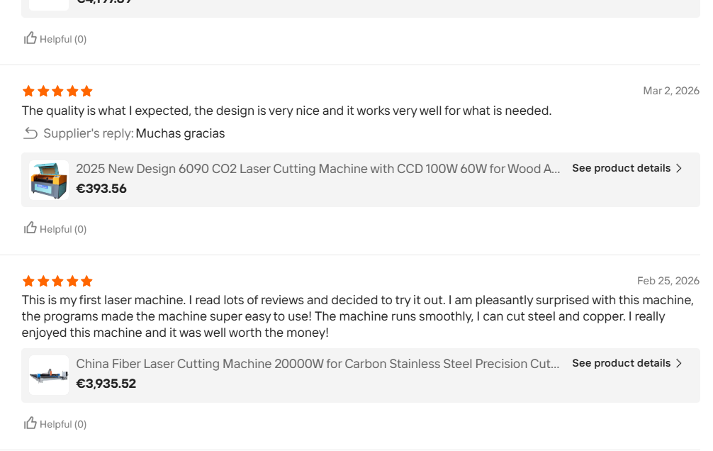

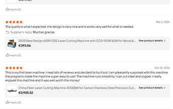

This is worth what it´s worth, but in the reviews there are other very low prices for other machines.
No, it’s not like I want to buy a product. When the advertisement already gives more questions than answers and the price is unrealistic…then I’m gone.
Nowadays, it’s safe to assume all reviews on all shopping sites are fakes generated by AI / LLM agents. Some reviews may come from actual human beings, although they typically operate in slave-labor conditions.
