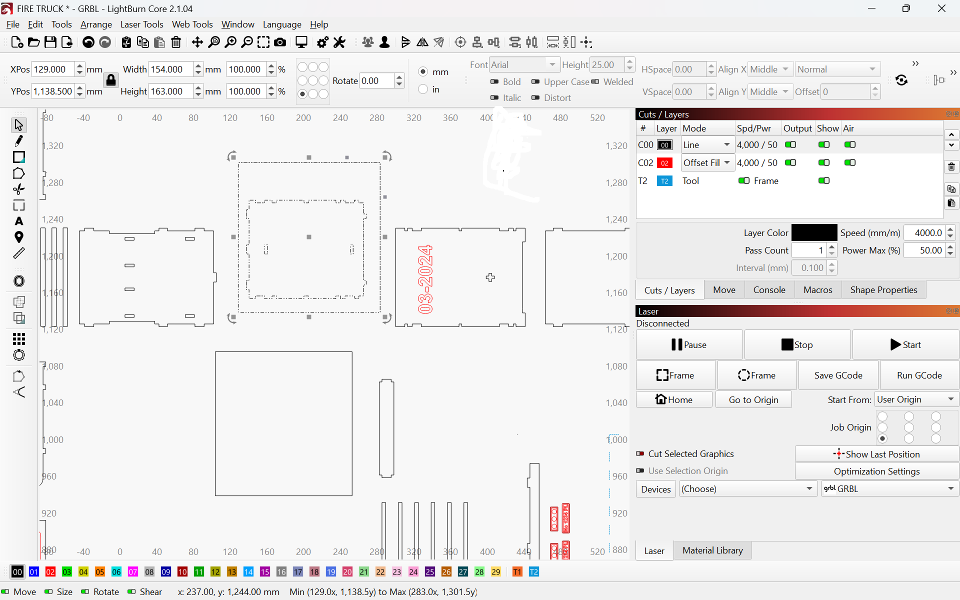

I recently bought this file but it shows as being too big to fit my Atomstack Pro 20 Watt laser machine. How do I cut it into chunks that will fit my 400 mm square laser bed.

I have drawn a box around the shape and selected both (with Shift) I will try and get a screenshot

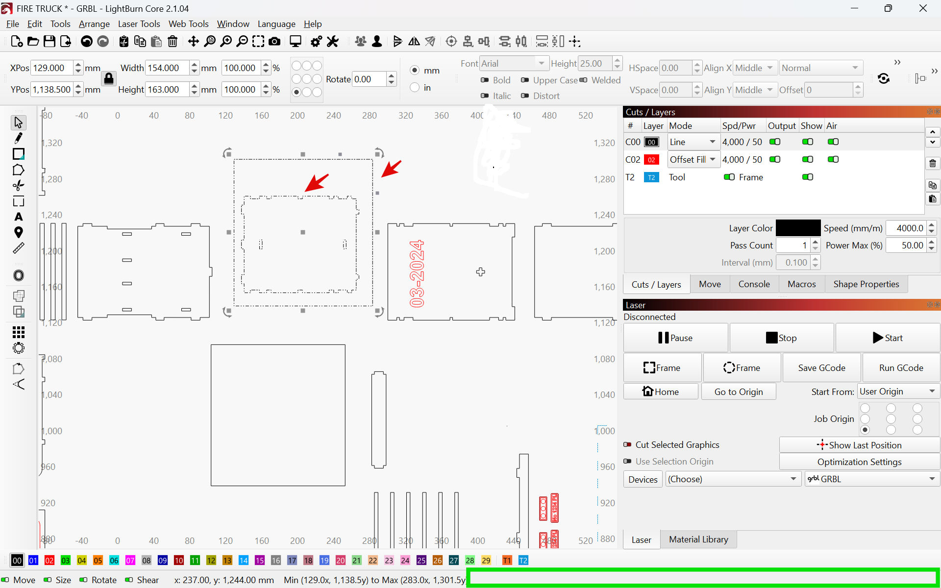

If I understood, I believe the first reason the feature appears in gray is that you are selecting an object inside another without any line crossings to be cut.
Another reason, though I’m not absolutely certain, is that both objects share the same layer. I believe you have to use different layers for the cut to be made. :thinking:
A great help comes in the latest versions, where the area marked in green usually shows tips on what is happening.

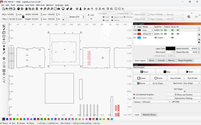

I did not see where you explained why you wanted/needed to do this. Your initial posting was about cutting something that is larger than your laser bed size
No one piece in your project exceeds the size of your laser. @bernd.dk said it when he told you to drag some parts into the grid and work on those a few at a time. You do not have to cut it all at once.
If I am misunderstanding your issue, then please let me know.
You have to Ungroup first.
then select the parts that just fit the laser workbed and run the job until you have all the parts cut. If using Absolute Coordinates place the parts you want to run in LightBurn workspace grid.
Keep track of the parts with a bit of painters tape on the reverse side of the parts.
Or draw a rectangle a wee bit smaller than the platform, select all the parts, and nest them to fit:

Easy fix. [1] Everything is Ungrouped in the file I downloaded. So any panel section with holes or engraving inside must be Grouped as a unit. [2] Turn on Cut Selected Graphics. Now the laser will only cut what is within the design grid and is selected.
Now you are prepared to move stuff in and out as needed. I recommend you use Absolute Coords to avoid coordinate issues.
