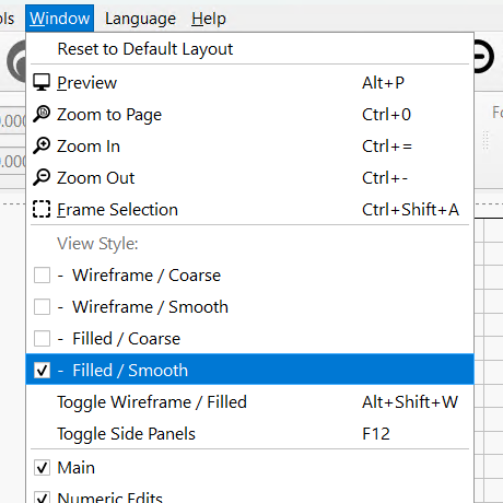

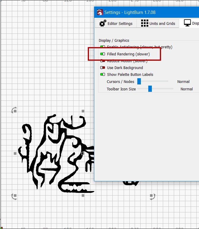

A file shows an outline of an object when the “fill” function is indicated in the cut layer. The cut preview panel shows the the object being “filled” by the laser. Debug Drawing shows some numbers at certain areas, but I don’t know how to interpret them. File attached. Please advise.

settings → display –
Perhaps View style is set to a Wireframe mode, rather than a Filled mode:
The doc suggests that mode is not for normal use:

I have mine turned on most of the time, unless I need to see the head path. Even on my slow 4-core cpu, it rendered pretty fast.
Ditto, although I need an inordinate amount of time to (remember to) turn filled rendering off when I have trouble selecting a vector shape obscured by the fill. :slightly_frowning_face:
Whatever you get used to.. been doing this for quite a while and try to keep my blood pressure down.
That was it. THANK YOU!!!
