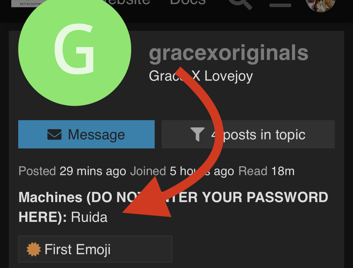

Don’t forget to change your profile. You had Ruida listed (which is why I asked if you had a 6442 or 6445).
