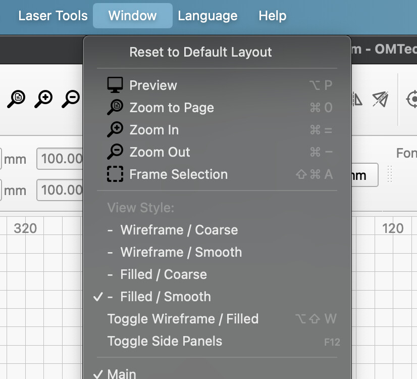

How do I make it so it is doing a fill for this logo instead of engraving the dead space? Thanks.
Duplicate the black ring and the fill will invert.
Original.
With black ring duplicated.
If you go to Window Menu> Filled / coarse or smooth you can see the results in the workspace.
