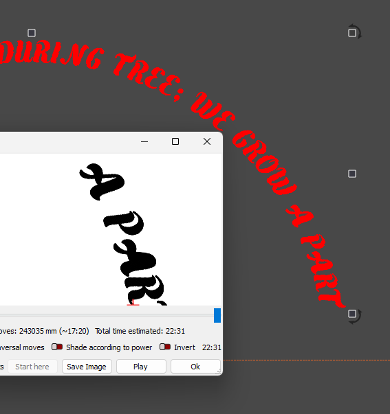

When i choose to fill fonts for some reason it fills in the center of some letters. I have the window setting to filled smooth so i can see what it should look like. when i do the preview, some letters will have the center filled in i have tried different fonts and rotated the fonts and it seem to move to different letters any help as to why this would be happening is appreciated
Can you upload the file?
The hallow parts are not grouped with the rest of the letters.
Select the shapes and use Boolean tools to put them together.
