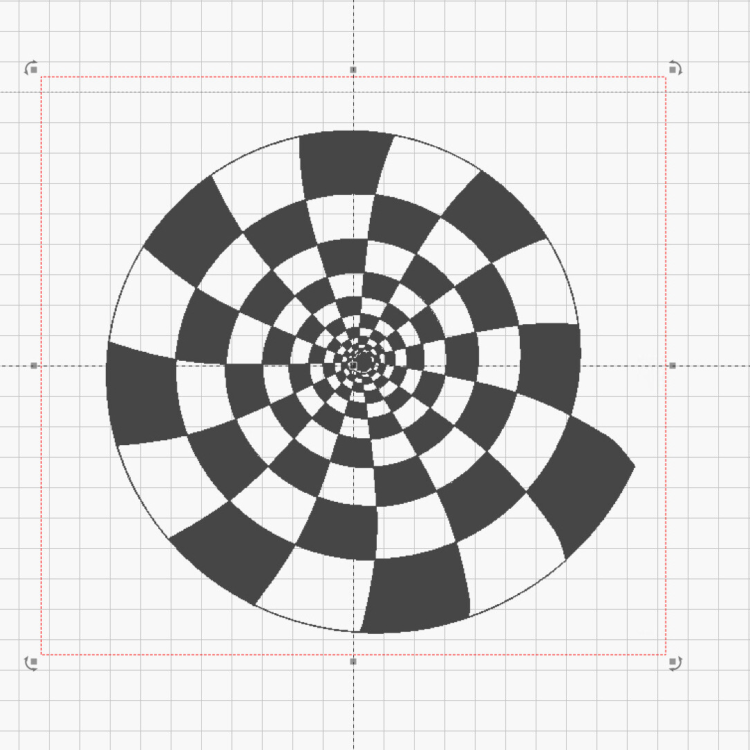

How do I fill the random shapes (marked with “A”) in the image below. The spiral is a vector image, the radial lines are overlaid. The fill areas are distorted rectangles.

separate the desired fields to a respective layer and set it to fill

> [@WoodArt](#):
Because those lines are not joined and do not form closed paths, the spaces between them cannot be filled:
> **[Open vs. Closed Shapes - LightBurn User Guide](https://docs.lightburnsoftware.com/latest/Explainers/OpenClosedShapes/?h=closed)**
> Read more about the differences between open and closed shapes and how to work with both.
In addition, the nodes around a closed path can join only two vectors. Each of the nodes at the “corners” of those shapes would have _four_ vectors, so none of LightBurn’s tools can join them.
_Assuming_ you want to fill all the alternate spaces around the entire spiral, the least-awful technique will (probably) be to:
- Import the vector drawing into a bitmap graphics editor like GIMP
- Thus converting them into the equivalent raster image
- Click GIMP’s `Fill` tool in the desired areas
- Save as a PNG file
- Import into LightBurn
- Set speed & power as needed
- Fire The Laser to engrave the image

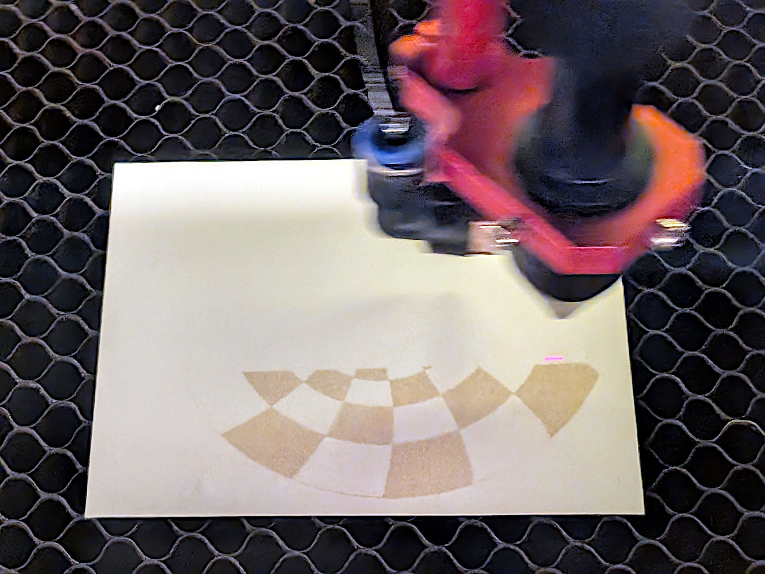

I cleaned up the screenshot to produce this PNG image with a transparent background:
 ![Spiral blocks](https://forum.lightburnsoftware.com/uploads/default/original/3X/6/2/624d111c096de29b08d2875a31c9b9741344b4e1.png)
Importing produced this LightBurn image layout:
 ![LightBurn - Spiral blocks layout](https://forum.lightburnsoftware.com/uploads/default/original/3X/2/4/2493bcf6abc24b2633db94b9e907f409abe19d05.jpeg)
Scale it to fit a random piece of cardstock:
 ![LightBurn - Spiral blocks engraving](https://forum.lightburnsoftware.com/uploads/default/original/3X/b/c/bcdeacfffbdaa2477533ef9858a1832d8dc95169.jpeg)
There are other ways to get the job done, but that’s quick-n-easy.
