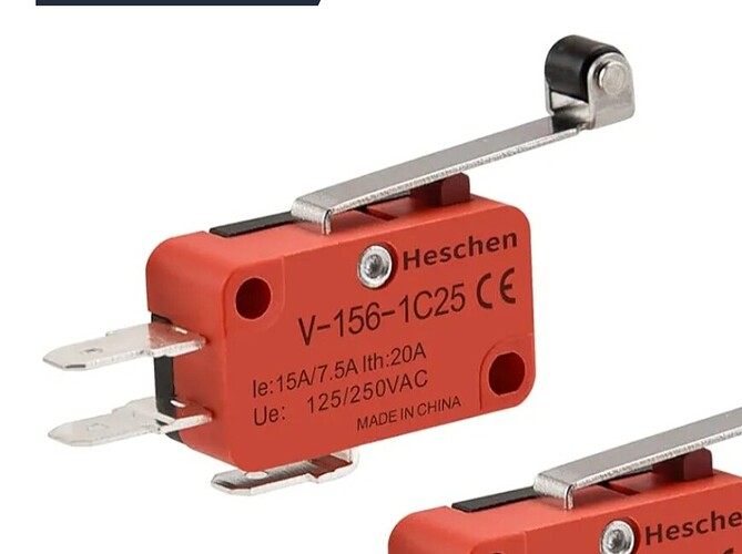

Otra pregunta si uso este final de carrera solo conecto dos cables en común y NC no?o tengo que poner tres cables?
Another question, if I use this limit switch, I only connect two cables in common and NC, right? Or do I have to put three cables?
The control board, when set up for limit switches, can be set for Normally open (where the closed switch is the trigger) or Normally Closed (where the open switch is the trigger).
Generally, the Normally closed Limit switches are preferred because a broken switch wire will show the switch in the limit state.
A controller board without limit switches could be equipped with Normally Open switches because the inputs will read in the resting (un-triggered) state.
Yes, two wires are enough. Three wires are only required for switches that have an additional LED showing the activated state.
