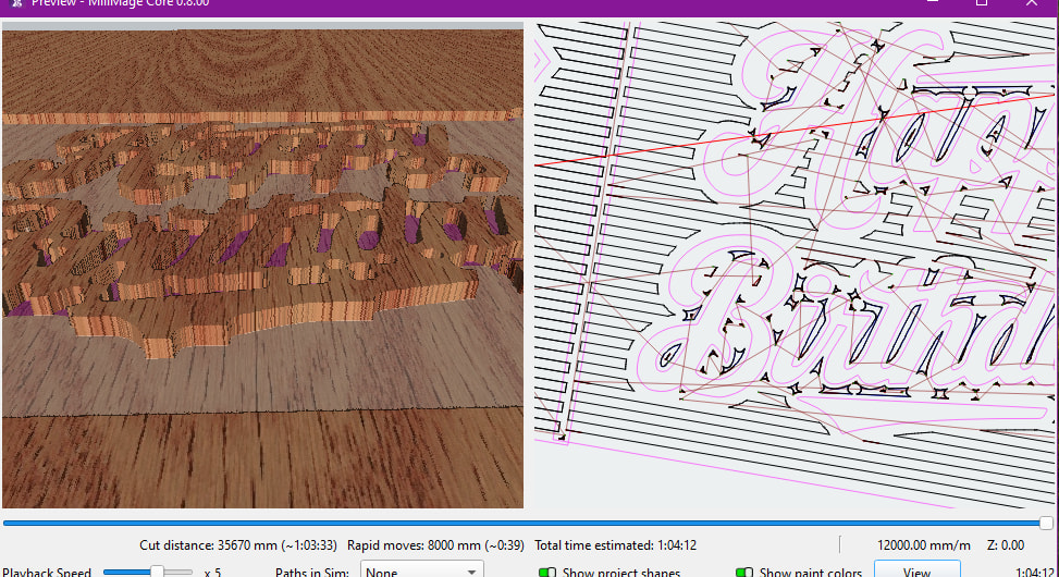

created job yesterday with 0.5mm stock to leave on roughing, pocket assigned , yesterday in preview it showed correct paths with finish as design removing stock to leave , on opening job today in preview no finishing paths assigned , when click on operation it highlights design where path is, so they are still assigned

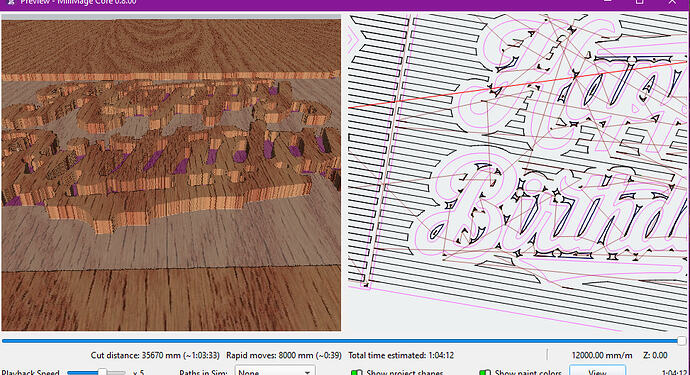

rest pocket when set on offset , no outline finishing pass shows

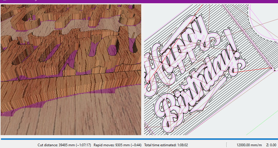

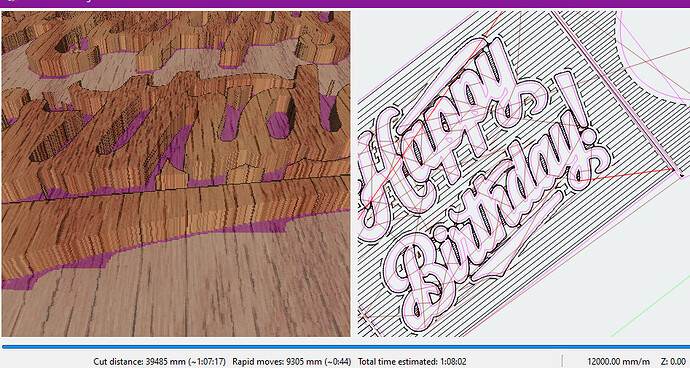

change to raster and it previews correctly
correct me if im wrong but it should do finish path in either
offset
raster and leaving uncut pieces in middle,
i do remember this was a bug way back when , but was sorted
If you post something like this, the best way for us to investigate is to see the actual file. If it’s not something you’re comfortable posting in public, email it to support with a link to this thread.
Edit: actually, if you did a pocket with a “stock to leave” amount, and then did a rest pocket without it, there’s no way for the rest pocket to know that at present - the ops aren’t linked.
They will be at some point, but for now, rest won’t be compatible with stock to leave.
