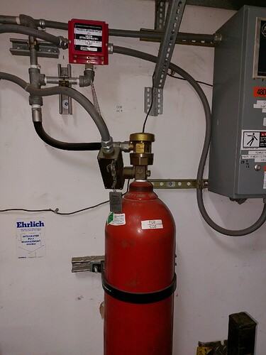

Having had the meltdown myself So, this happened ('small' fire) , there are a few options along the way to keep this from happening again. Now that I’ve had to move the machine into a much smaller area (since my wife’s candle business has grown well past mine) in the garage attached to the house instead of the shop, I’ve added in a 15lb CO2 extinguisher with thermal fuse valve. It gets hot in the cabinet, the valve lets go and dumps the whole bottle. Bit of $$$ and plumbing in the process, but keeping fire out of the house was a good motivator.
I understand fusible link but cannot find anything on thermal fuse valve? I am just starting to use my fiber laser again and am still working out the thermal cutoff for the laser and exh fan, so I am still researching.
RE: your fire- I have a couple chosen employees who can use the 130W CO2 laser and have this in front of their faces…

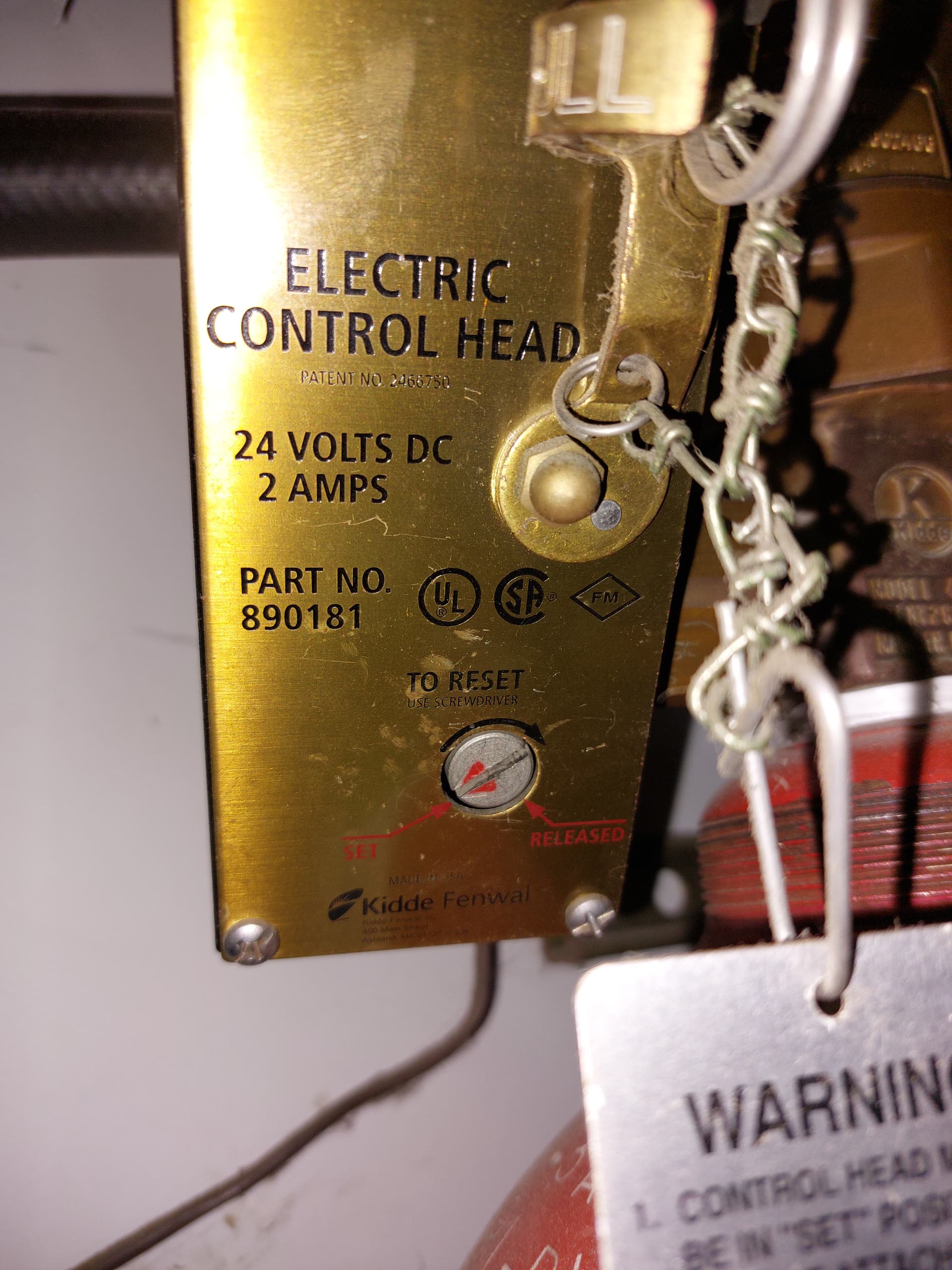

I got mine out of an older replaced CO2 ANSUL style system. You can probably find a high pressure solenoid that would do nearly the same thing. However, you’d have to make sure to turn it on/off so you don’t blow by if it changed state accidentally (power loss/power on) and not with your system as you design it. Mine is 'set it and forget it. If my bottle does go dry, it’s because I have a leak or I had a fire. There are also system activated valves designed specifically for fire protection. We have a few at my retirement job. They spray CO2 directly into the dust collection just in case we start something we didn’t want to start. These are full size “H” cylinders, so I’m sure it’ll work in much smaller instances. I can’t guess cost, but I’m guessing not home owner/small business friendly.
Maybe you can clarify how this works? You have the thermal valve, which I assume is entirely mechanical and requires no power. I looked at the link, nice photo but I see no information on how these work or what the specifications are. I assume there are variation like a quick acting or slow blow type fuse?
How does the solenoid valve operate? Does it have a sensor and where is it’s power arrived.
