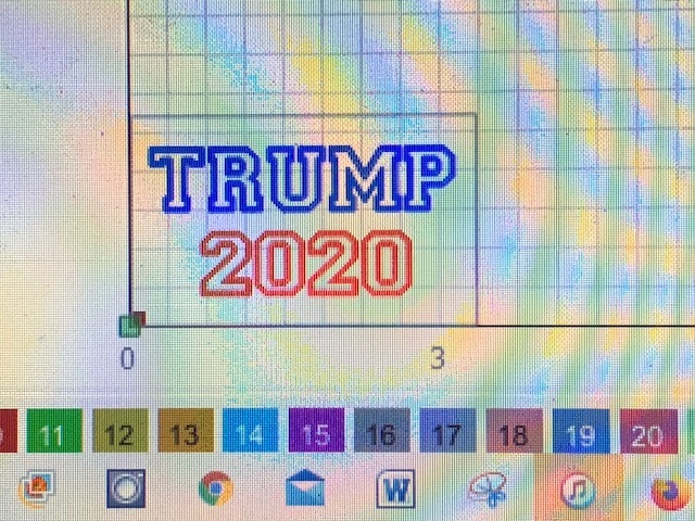

First Burn - Need Help With Alignment
This is my first time project and while it shows centered on the software screen, it’s obviously not on the material. Please help!!!
IMG_1799
Can’t help on the alignment, but I will applaud you on the wonderful choice of graphics!
:grinning:
Thanks
What machine are you using? What Controller? What is your origin point?
Ortur Laser Master 2, GRBL, front left
Figures, total opposite of what I use. I have an 80W China Red with a Ruida controller with origin in the back right… LOL
I will throw a few things out and see if some of it translates. For me, the actual corner of the text is the corner point, not the oversized box around it. Especially if I set that box for reference and not cutting. If I need to use it for positioning, I set the box at 1% power and 150mm/s. Well below the level of actually firing the laser, but the controller then recognizes the box and does a quick trace before going on to the part I really want. I have to do the same with a set of nested boxes for engraving rubber stamps to get them to come out right.
