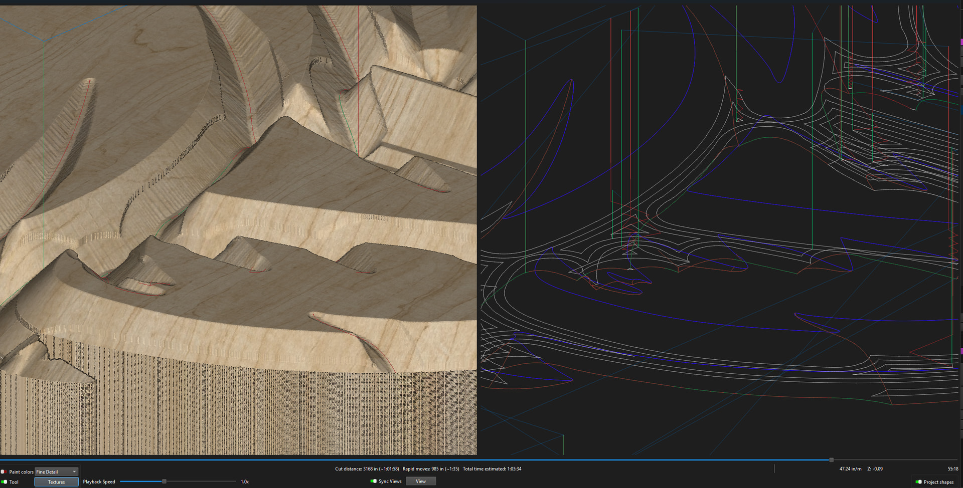

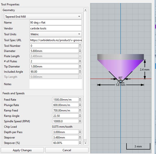

i have a 90 deg v bit with a 1mm flat bottom which im setting up
picking this is right way in tools, it looks right

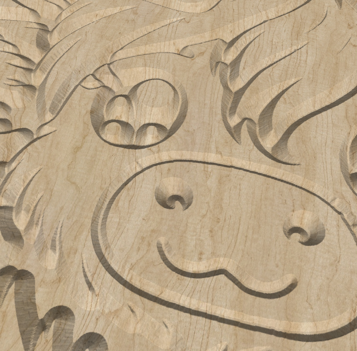

in preview the outside edges have a step down at base, is this correct or a problem
1: way of thinking being flat is clears bottom say like end mill giving cleaner base
2: does it need to step down like this to get the correct angle along outline of operation
3: even if you change max depth to 1 mm it still steps down
4: wall step in at a 6mm cut , i get flute length says 2.4mm , but if you preview the 90 deg v with a point which is 3mm length it has a smooth wall edge
because the is no tip and it is flat , my thinking is it needs to go 0.6mm to achieve the final outcome but shouldn’t effect the edge
or is it like a pocket operation and than a profile cut last
lastly if it is correct what is the depth of that step down in preview is it the 0.6mm missing from the point

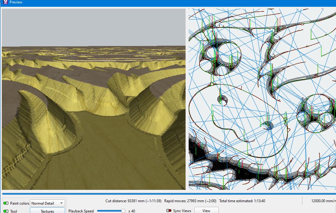

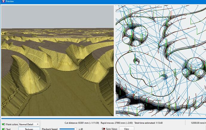

Looks like you have it .236 depth, .11811 Stepdown, so I would expect 2 passes as well. I see 3
This persists even when changing to .250 depth .125 stepdown.
It looks like the tool is doing a pass along center of the VCarve but not taking into account the flat bottom. Asking for more info internally

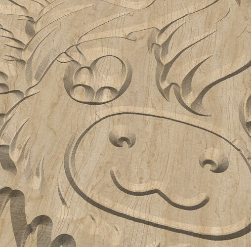

This is a pretty straightforward bug in the handling of flat-tipped V bits. I was using the wrong value to account for the shortening of the bit by the tip diameter.
With that bug fixed, your file looks like this:
Thanks for reporting it!
