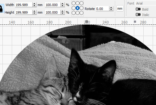

It is showing 199.989 mm for me
 ![image](https://forum.lightburnsoftware.com/uploads/default/original/3X/c/c/cc8bee475e0726cf0091a2594010e366a4427d23.jpeg)
That might be in the margin of error of the line thickness.
That’s like a drop of 0.005% 😃
Is that the difference you are seeing as well?

While I agree there is a difference, It cannot be in any way shape of form noticable in a practical sense as we talking about 0.00x mm
Your laser will not have such a definition.
Numerically its different yes, I will inquire about why this difference happens.

> [@steveh70](#):
> seeing as it never did before
Sounds like @gilaraujo is detecting a rounding error. Is it possible you did just not notice it before, or there were changes the location of your drawing slightly in the workspace. As Gil sort-of said, micrometer errors in a millimeter world are not worth worrying about.
