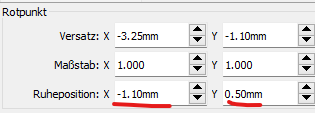

I am a beginner. My Monport 30W MOPA fiber laser has an autofocus and I have not dealt with the focus yet. That’s why I didn’t realize that there is a switch to activate the second red laser dot.
When I activate them and use the autofocus, I notice that all three dots never meet. Even if I set it manually, the three dots never meet. Two points meet exactly, but the original laser point is always slightly offset.

I was able to adjust the laser in Lightburn. Now it should fit.
