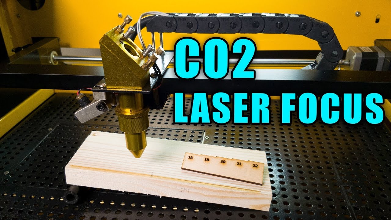

Hello,
Does anyone know a proven method to reset the focus after cleaning the lens. My method is trial and error and it can take me a few hours to perfect.
Thanks

You should conduct a “Ramp Test”. Once you know the proper focus height you should cut out a piece of material that fits that focus that you need. That way you can slide it under the head and tighten manually. (I’m assuming you have a diode laser?) even with a CO2 this would work

This will work with either laser. It’s about finding the focal point.
[![](https://img.youtube.com/vi/tPrY3bFdtIw/maxresdefault.jpg "CO2 Laser Focus / Focusing Laser Lens Ramp Test - Laser Engraver Beginner Series Ep. 6") ](https://www.youtube.com/watch?v=tPrY3bFdtIw)

Great video, thanks! I’ll definitely be using this method and making a guid tool.

Thank you LaserWillie, this is a really good video. Is it the same for the adjustable type diode? I can set the height for the diode, but I’m lost when I need to fine tune the adjustable lens.
Thanks

Yes it is the same. You just find the appropriate distance and make a guide for that distance.
