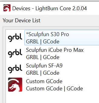

Do you have 2 devices listed when you click the Devices button?
When I power up, the S30 is the default because it is at the top of the list. When I click on the SF-A9, Lightburn will readjust the workspace and reHome the laser.
Almost: it’s the default device because it’s marked by the tiny asterisk.
Pick a device, click the Make Default button below the list, and that’s the one with the asterisk.
Yeah, that too. Missed that one! :rofl:
Yes I have set up one manually called FoxAlien, but the settings are exactly the same LaserStorm as they are the same size and zero point. I have no control through Lightburn as the Alert comes up instantly.
