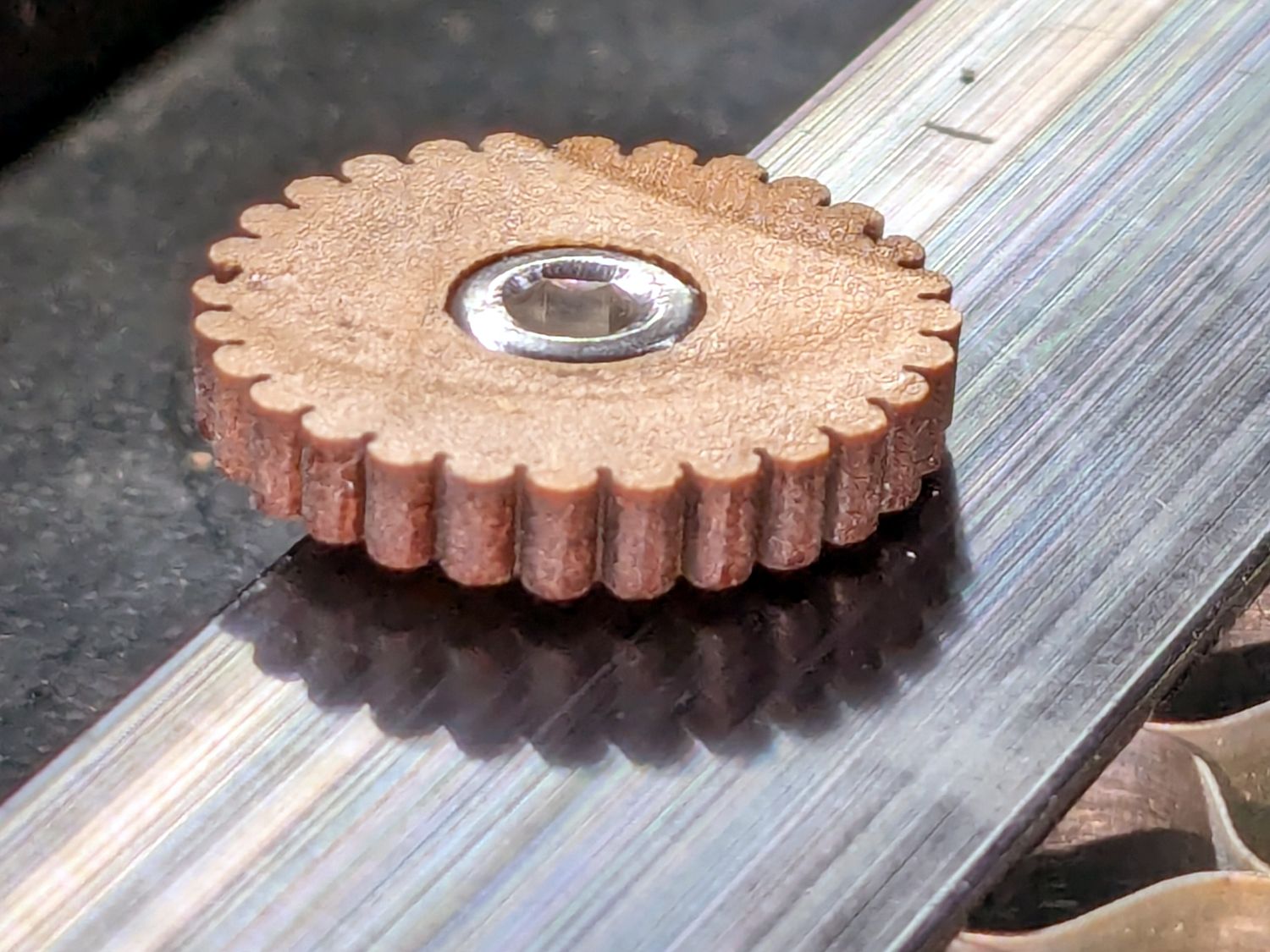

> [@Page](#):
> honeycomb bed alignment
Make that problem Go Away Forever:
- Drill a pair of holes through the honeycomb frame
- Match-drill holes in the machine platform
- Squeeze rivnuts into the platform holes
- Screw the platform down
You could get much the same result by fastening / taping a pair of (laser cut!) L brackets on opposite corners of the platform to align the honeycomb.
The honeycomb in my machine came with crudely drilled holes that kinda matched two crudely tapped platform holes, so I [cleaned things up, installed rivnuts, and put cute knobs on the screws](https://softsolder.com/2024/04/30/omtech-laser-cutter-honeycomb-rivnut/):
[![](https://softsolder.com/wp-content/uploads/2025/03/pxl_20250305_141727825-honeycomb-screw-knob.jpg) ](https://softsolder.com/wp-content/uploads/2025/03/pxl_20250305_141727825-honeycomb-screw-knob.jpg)
Basically, fasten the honeycomb down and move on.

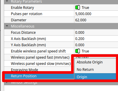

On mine you can set where it will return, at least you have three options. In the controller there is a _ **return position** _.
 ![image](https://forum.lightburnsoftware.com/uploads/default/original/3X/c/a/cab2bc9d9d4f3b748aaef28466fe75875b72cd8f.png)
