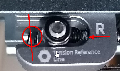

I’ve got a Ortur LM3 20w 400x850 laser. I’ve got everything right yesterday but where I get stuck is the Frame function. Whenever I do a Frame, the machine rapids fast to the Home position, hitting the frame hard and do the framing from Home position slowly to the other end of the X-axis. It ends up stopping at the Y-axis end and in the middle of the X-axis.
The machine has homing switches. I setup the machine so when it boots up it goes to the Home position automatically

A couple questions
Have you extended the frame on firmware $131 settings?
Is the machine homing correctly?
Can you take a few pictures of your Belt tensioners?

I didn’t extended the frame on Firmware. Where do I add the $131 for the extended frame?
The machine homes perfectly
The belt tensioner is adjusted to the line on the tensioner. The image I sent now, the tensioner wasn’t on the line but it is now.

Given that your Y is extended you must tighten them a bit more than marked
 ![image](https://forum.lightburnsoftware.com/uploads/default/original/3X/c/7/c70b475baadb427e9c9a88beb3ddbea7e5c0ca72.jpeg)
Both sides

In fact the tensioners are there where your red reference are. I’ve just checked now, my bad. I just took an old image to upload.

In the Console window, type $131=850
Press enter
Then try again homing. The Laser should home correctly without Alarm 9 or Alarm 8
Triple check the belts though, on the extended version is quite important to have them perfectly tensioned
