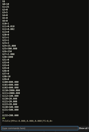

From the console entering :$$
Sorry… attached an image… here it is typed out…
$0=10
$1=25
$2=0
$3=5
$4=0
$5=0
$6=0
$10=1
$11=0.010
$12=0.002
$13=0
$20=0
$21=1
$22=1
$23=3
$24=25.000
$25=500.000
$26=250
$27=2.000
$30=1000
$31=0
$32=0
$33=0
$35=0
$36=0
$37=0
$38=10
$39=0
$100=800.000
$101=800.000
$102=800.000
$110=2000.000
$111=2000.000
$112=100.000
$120=20.000
$121=20.000
$122=20.000
$130-500.000
$131=500.000
for reference, you can right click in the console and select all > Copy.

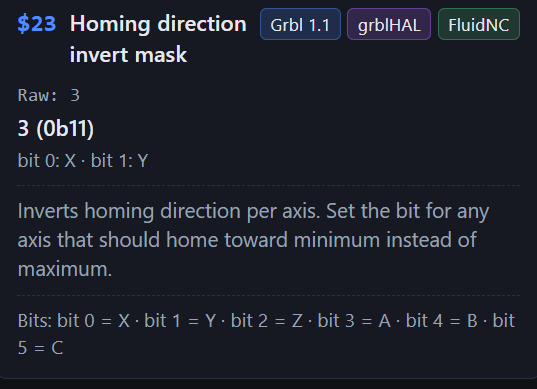

So on this new board you inverted direction of your axis, as well as the homing corners
It now homes to the correct corner, its the framing that doesn’t work now. I can frame using lightburn but millmage will not frame, it tries to go out of bounds. I have tried to frame with both my laser and my cnc mill. With both programs. Lightburn frames just fine on the cnc mill and the laser, but millmage will not frame with either one… it is something with the program. It took me forever to figure out how to fix the homing. Both now home correctly in both programs.
If you do not get this right, you will Home and Jog, but it can still be operating in the wrong quadrant. Trust me, I learned from experience when I replaced my CNC controller board that was supposed to be a direct replacement.

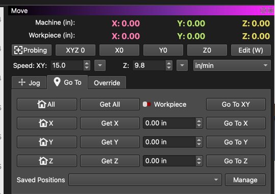

You have no work coordinate offsets, so this should be 0.0.0, or very close when you Home the CNC.
When it Homes, does the table retract and the laser move left?

This is a screen cap the move window, even with my project selected.

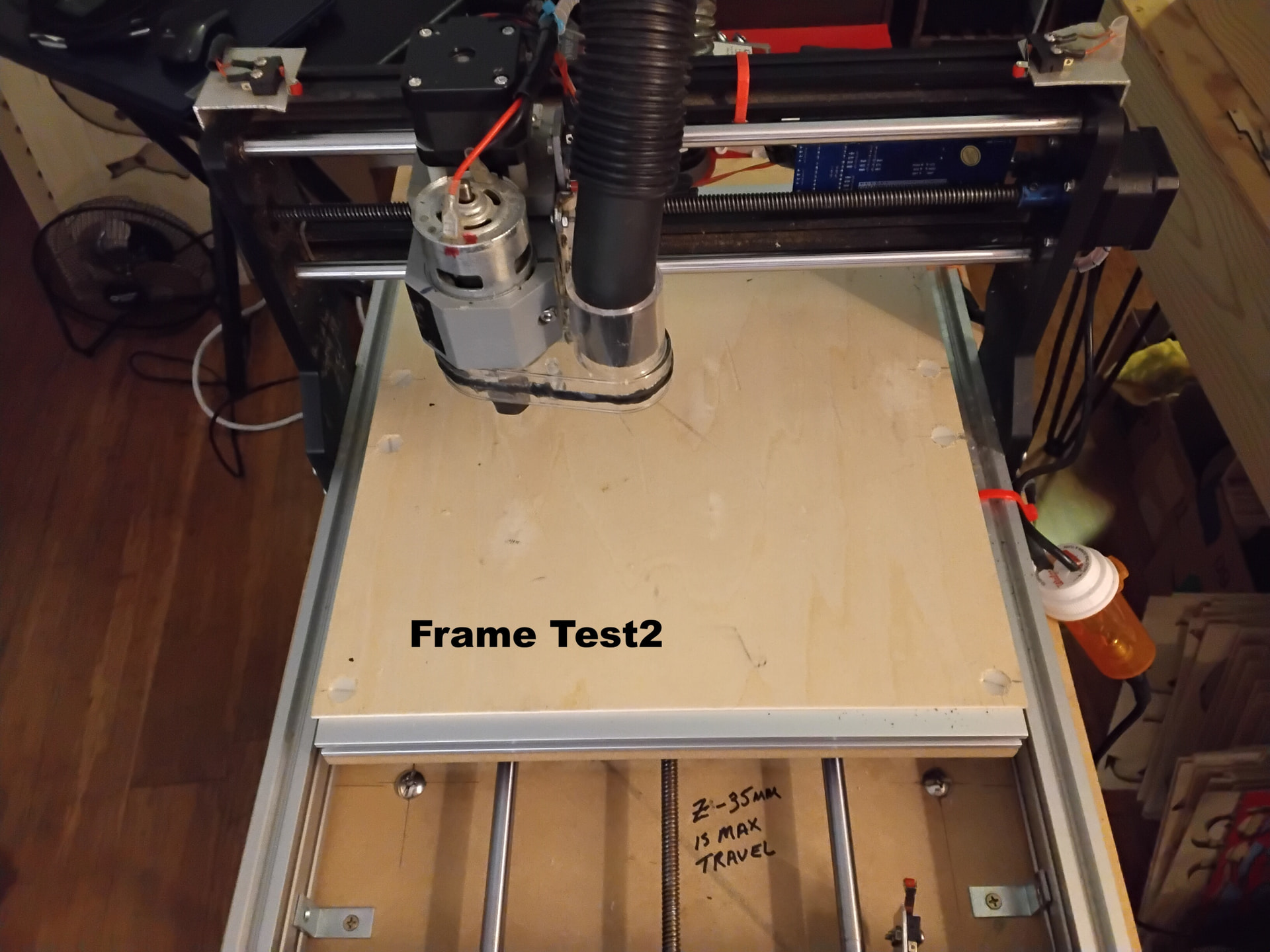

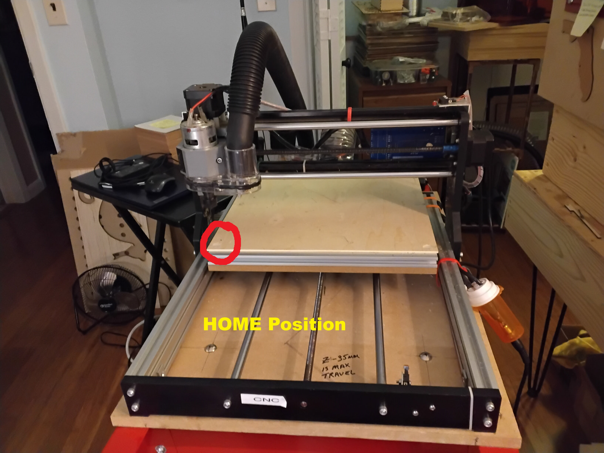

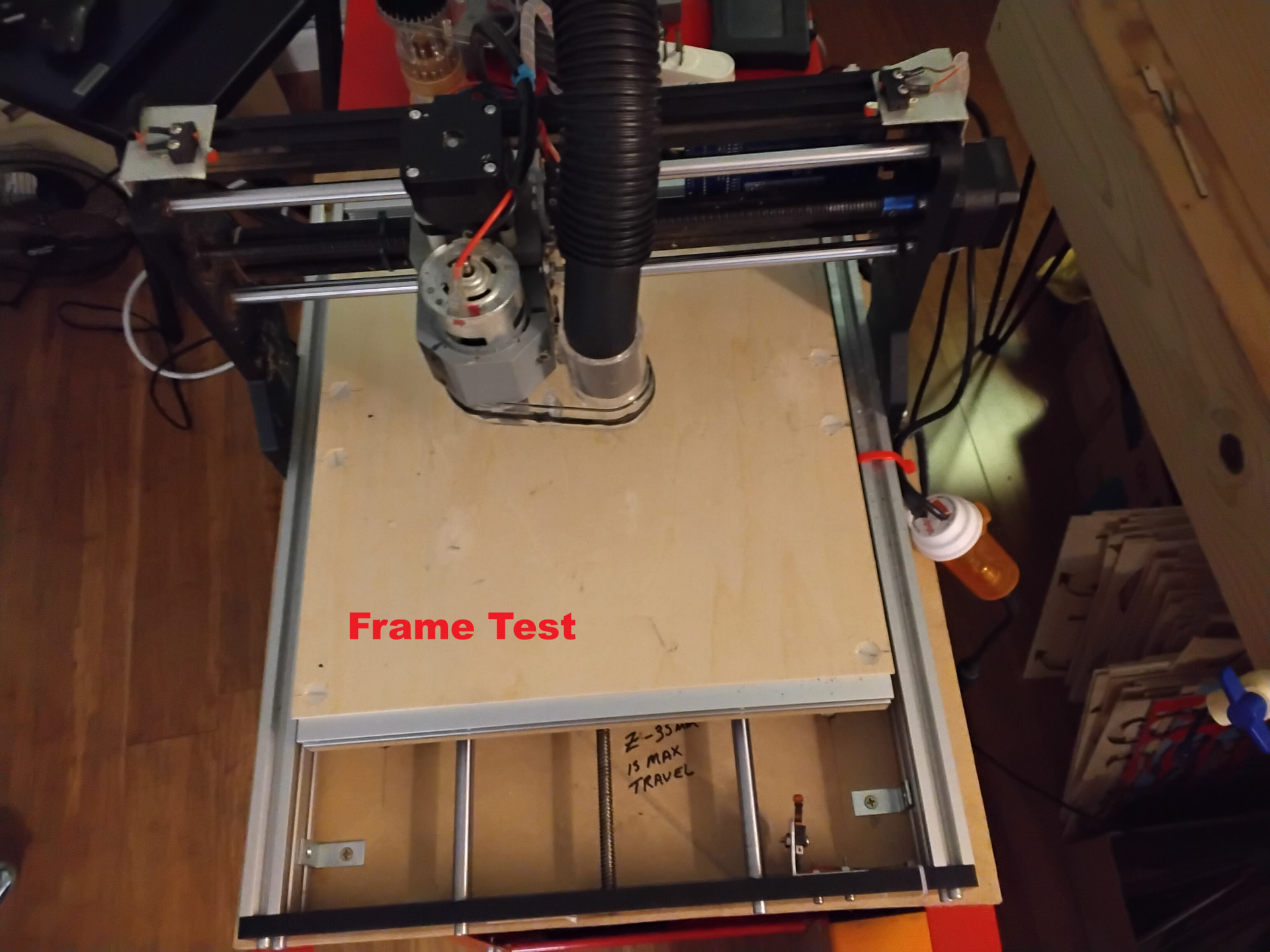

I have created 2 test files. The first has a material size of 380mm x 380mm and 2.8mm thick. This covers most if your CNC work area. The second is 100mm x 150mm x 2.8mm. This represents a typical piece of wood to engrave. I chose thin so the Preview would look nice.
I see “Ortur” in your Bio. I am guessing you use Lightburn. There is one major difference, Lightburn design space is the work area of your laser. MillMage design space is the size of the material you are cutting. However, MillMage is always Absolute Coordinates, meaning your front left corner of the block defaults to the front left corner of your machine. (For anyone else reading this, this is for her machine which homes front left and displays 0,0 in the Move window.)
First Image:
This is what your spindle position should look like when you Home the CNC..
Second Image:
The spindle should Frame near the middle of your table.
Third Image:
Although this is exactly the same design in the middle of the design grid, the spindle will now Frame near the front left corner on the CNC table.
Do the FRAME in each of the programs and let us know if you get different results than what I described. If so, then we have some homework to do. :grin:

It looks like your $100, $101, $102 (X,Y,Z) step resolutions are too high at 800 steps/mm… probably should be just 80, not sure about your Z (400 maybe?). You can easily check by commanding a small fixed length jogging movement using the ‘Z Distance’ field in the Move Window, and then measuring the actual distance the Z axis travelled.
I’m guessing that is why you keep crashing, and why your acceleration/homing speeds in the GRBL settings are set low.
If it is a screw drive, 800 is okay. If it is a belt drive, then it should be 80.
@NicholasL and @MikeyH, Yes, you are both correct… my step motors were set at 800… I installed the Grbl generic driver… which has caused me to need to do a lot of trouble shooting… I changed the 100, 101 and 102 to be 80 instead of 800 and it is now framing the test frames Mikey sent. :slight_smile:
