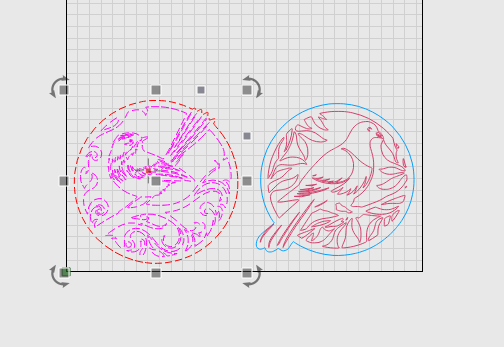

Framing both items

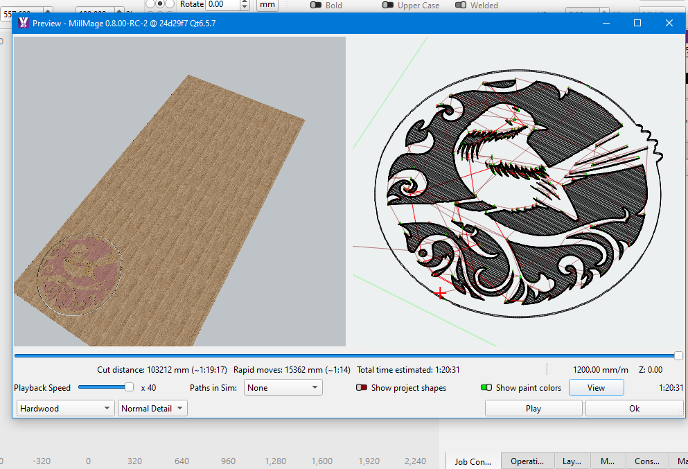

only have left item framed and tool paths allocated to it
nothing allocated to item on right
when i frame it. It frames both. should it only be framing highlighted item ohn left

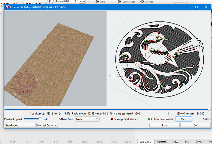

preview dosent show item on right

I had the same thing happen to me. I had two images. Only one had an operation set for it. When I tried framing, MillMage frames both images. The preview only showed the one with an operation.
