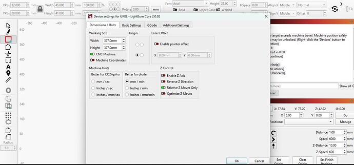

It’s a cnc mechanic s as it seems. Make sure to enable cnc mode in device settings or use current position as start mode.

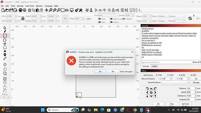

ALARM:2
G-code motion target exceeds machine travel. Machine position safely retained. Alarm may be unlocked. (Right-click the ‘Devices’ button to reset the connection)

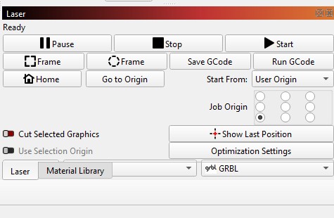

So I tried to use current position but I got this message.
 ![current position](https://forum.lightburnsoftware.com/uploads/default/original/3X/2/d/2db9f55b43d88194e6c20167ab165a1060405b0b.jpeg)

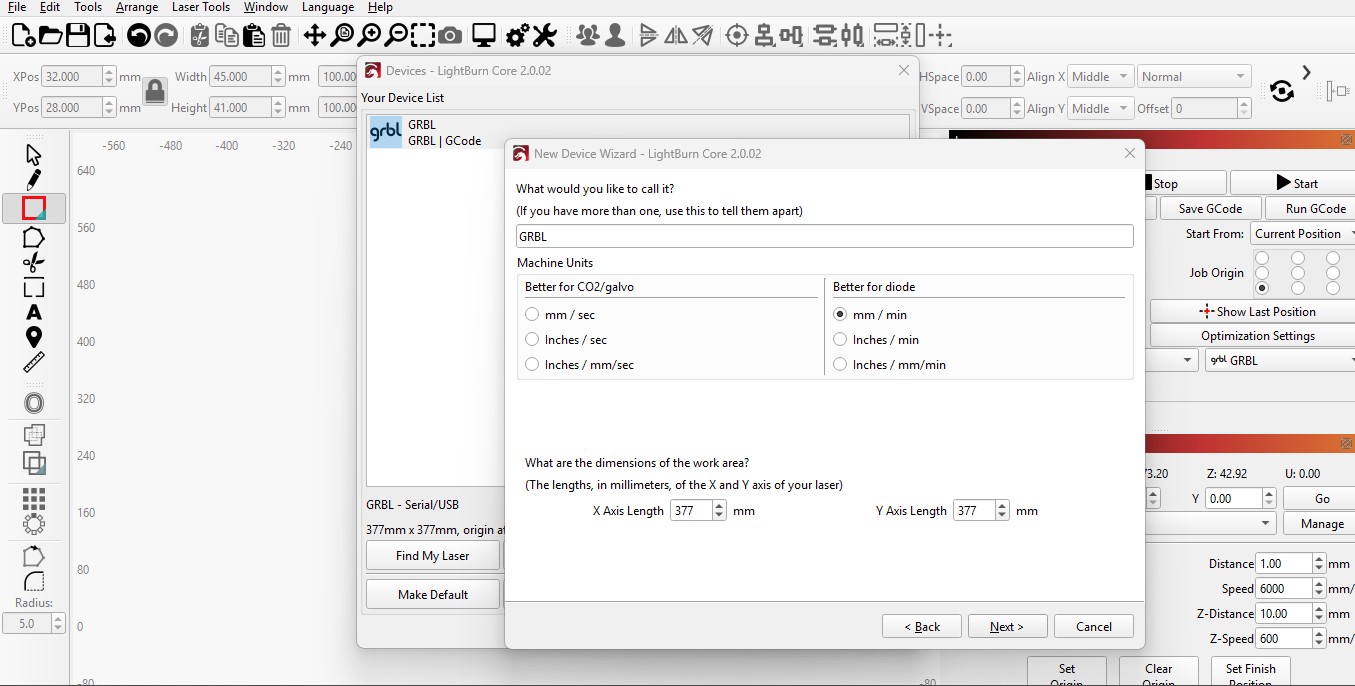

I changed my work area in
-$$ to 377x377
-device settings to 377x377
-Laser \> devices \> grbl \> edit \> grbl \> next \> serial/usb \> dimension of work area (made sure to be 377 x 377)
 ![work area](https://forum.lightburnsoftware.com/uploads/default/original/3X/2/b/2b2dd32dcff6594955926d19b932cf26828d20a6.jpeg)
 ![work area in devices](https://forum.lightburnsoftware.com/uploads/default/original/3X/7/b/7b49fc1e71d130dd99b3908bc1262c3c92489870.jpeg)

Ok I got it working under current position after removing cnc machine setting
