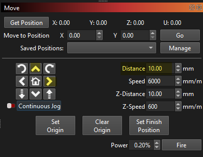

What LightBurn version are you running? 2.0.04? (Shows in main title bar or Help>About).
After homing, to test if your machine origin/direction settings are configured correctly, try to jog the laser head towards the centre of the working area using the back (Y+) and right (X+) direction arrow buttons in the ‘Move Window’ as highlighted below;
  • Set the ‘Distance’ to 10mm
  • Y+ should move the head away from you and toward the back of the machine?
  • X+ should move the head to the right?
Do you see any error or alarm messages in the Console Window? If so, please copy and paste them back to us:

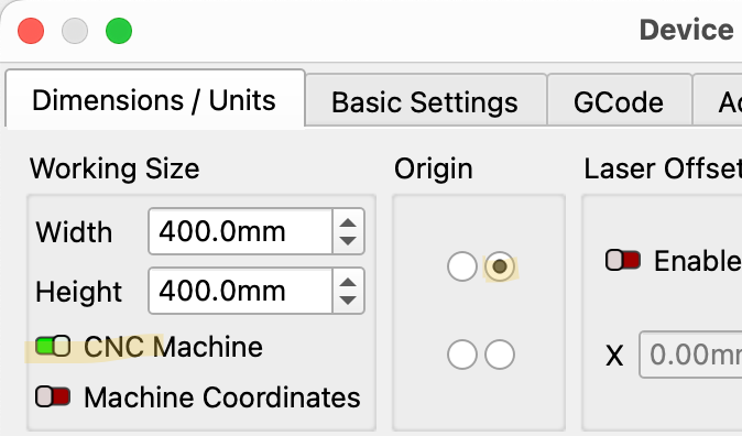

If you see it, enable the ‘CNC Machine’ setting in device settings, and set the axes Origin to rear right. This will cause LightBurn to address the machine in the negative machine coordinate space it is naturally in (instead of using the X-397,Y-397 G54 offset that was set before).
To test, these changes , make sure you are in Absolute Coordinate mode;
then try again framing and burning a small square, and check the size of it is as expected.
It is working. Thank you so much for your time and help.
