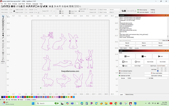

laser will frame single files but when the file has been ungrouped it still wants to frame and engrave entire file and bumps rails. lightburn version 1.7.07, I may not be describing this problem correctly
Post a screenshot (not a phone pic) of your entire Lightburn screen with the project in question loaded.

not sure I’m doing this right, it has been working correctly until yesterday, I’ve taken the screenshot but don’t know how to paste to topic
Drag and Drop the image from the screen-capture into your reply here.
Also, the Icon in the middle of the top row of the reply box (with the up-arrow) will allow you to browse for the file and upload it.

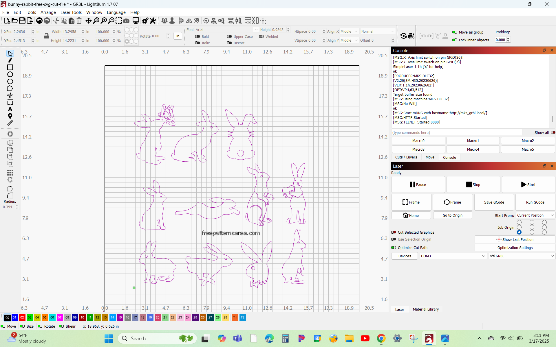

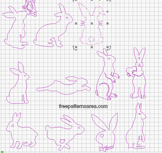

Is this what you need or do you need the full screen, I only have the one rabbit highlighted when I go to frame it frames the whole file and engraves the complete file instead of just the highlighted one. Thanks again John, here’s the whole screen too.
Select "cut selected graphics " button.
Thanks Al, that solved my problem. I don’t know when or how I unselected the parameter. Thanks again you’ve been a great help
