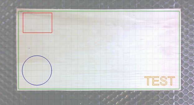

Hello. I am have some new problems when framing my work before I proceed to cut or burn. Usually I start most new projects with a box or circle around my work, to help me get everything lined up. What is happening is, when I trace shaped INSIDE of that larger box, it only traces the bigger outer box. In this example screenshot, it won’t frame the shape or text inside the box. And even when I delete the box it still traces the same large outline.
I tried with new files and new shapes and new projects. I am getting always the same problem.

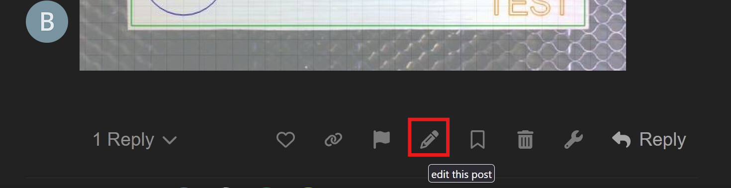

And off to your right you can edit with pencil.
Hi Ben,
I edited your post to say “framing” instead of tracing.
You can edit your posts with the pencil icon here:

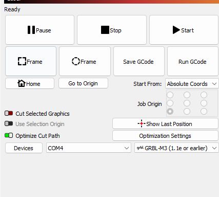

Which Start From option are you using in the Laser window?
Using a camera for placement only works with Absolute Coords

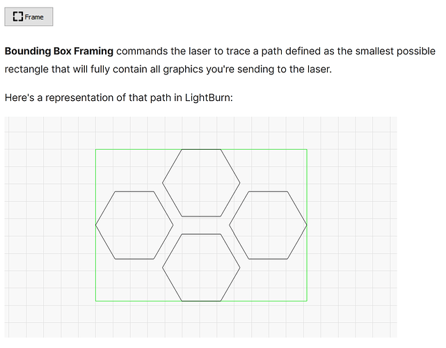

I believe, there’s a misunderstanding about how the framing works.
Please review this docs page.
Here’s a snippet of the relevant section:
Migrate the old settings to the new PC:
If you want it to only frame, say the circle, you must ungroup all of them and then select only the circle. If they are Grouped, then that is only one object.
Using that image with the octagons as an example. Imagine all of the shapes are NOT grouped and are individual shapes. I select one of the octagons to frame it and I do this to ensure everything is lined-up before I burn/cut. And that happens instead of just the octagon being framed, that whole green box that is outlining everything is being framed instead, even though I explicitly do not have the rectangle selected.

Just spotted something, why are you using GRBL-M3 as the Device Type?
I tested your file, but like you suggested I found it to be okay.
Switch from GRBL-M3 to GRBL and see if that improves your situation. I did a quick browse of the Forum for your laser and it appears to be a common flavor of GRBL.
