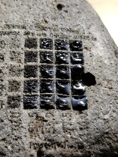

In my area, center of Arizona, I get all kinds of rocks, some volcanic and some sedimentary and probably everything in between. Some of these work well, some just end up as glass.
This is a volcanic rock done with the 60W fiber…

Is that what you could call Glass in the right column.
If you could get some depth with a suitable rock type and of a different color, then fill the engrave nearly up to the top with dust from the rock in the pic..Then Laser liquify it, That might be a nice thing.
Sounds like too much work!
Angle grinder with a big box to catch the…Yeah thats too much work!
With some types of rock, one set of parameters can engrave into the rock, while a different set of parameters can vitrify the surface (or make bubbly obsidian-looking glass of you go even further).
I actually use that as a design choice in some of my rocks. A micro-vitrified surface finish at the bottom of the engraved areas can really make it pop, and it also drastically changes how the look changes when dampened.
With other rocks, I haven’t found any good engraving settings for making the deep features, as the rock turns to bubbly glass far too easily. Anything that gets much of any contrast tends to result in vitrified patches just flaking off, leaving the material below unaffected.

I’m far from being a specialist with these. As you can see from the photo, it produced virtually no dust that was found… just heated the rock until it melted. Since it’s a fiber, I do have a number of ways of heating it, but haven’t really tried to engrave with volcanic rocks. From my memory, it was a lot more difficult than I had imagined.
I think about every kind of rock is different and machines differently.
