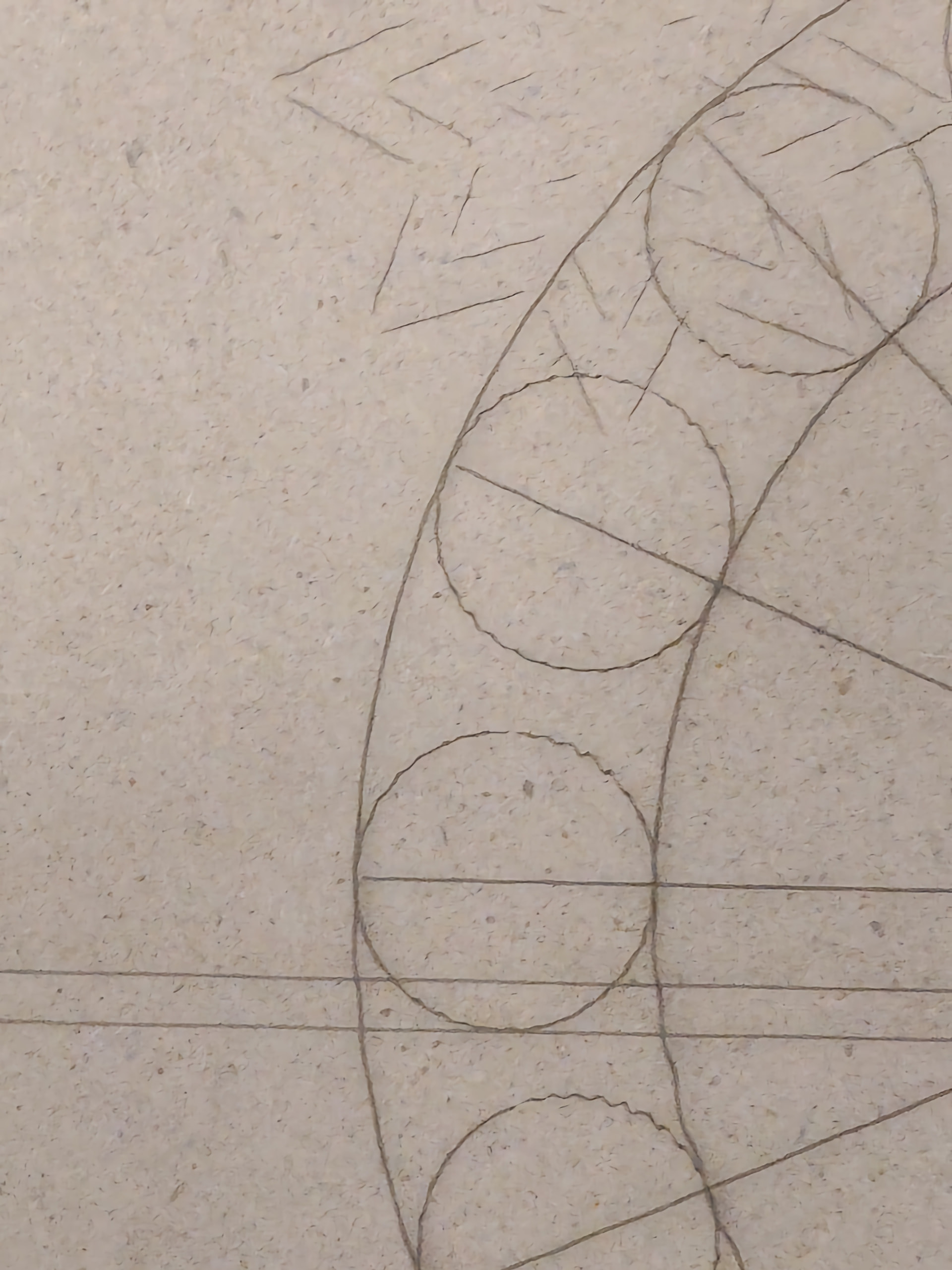

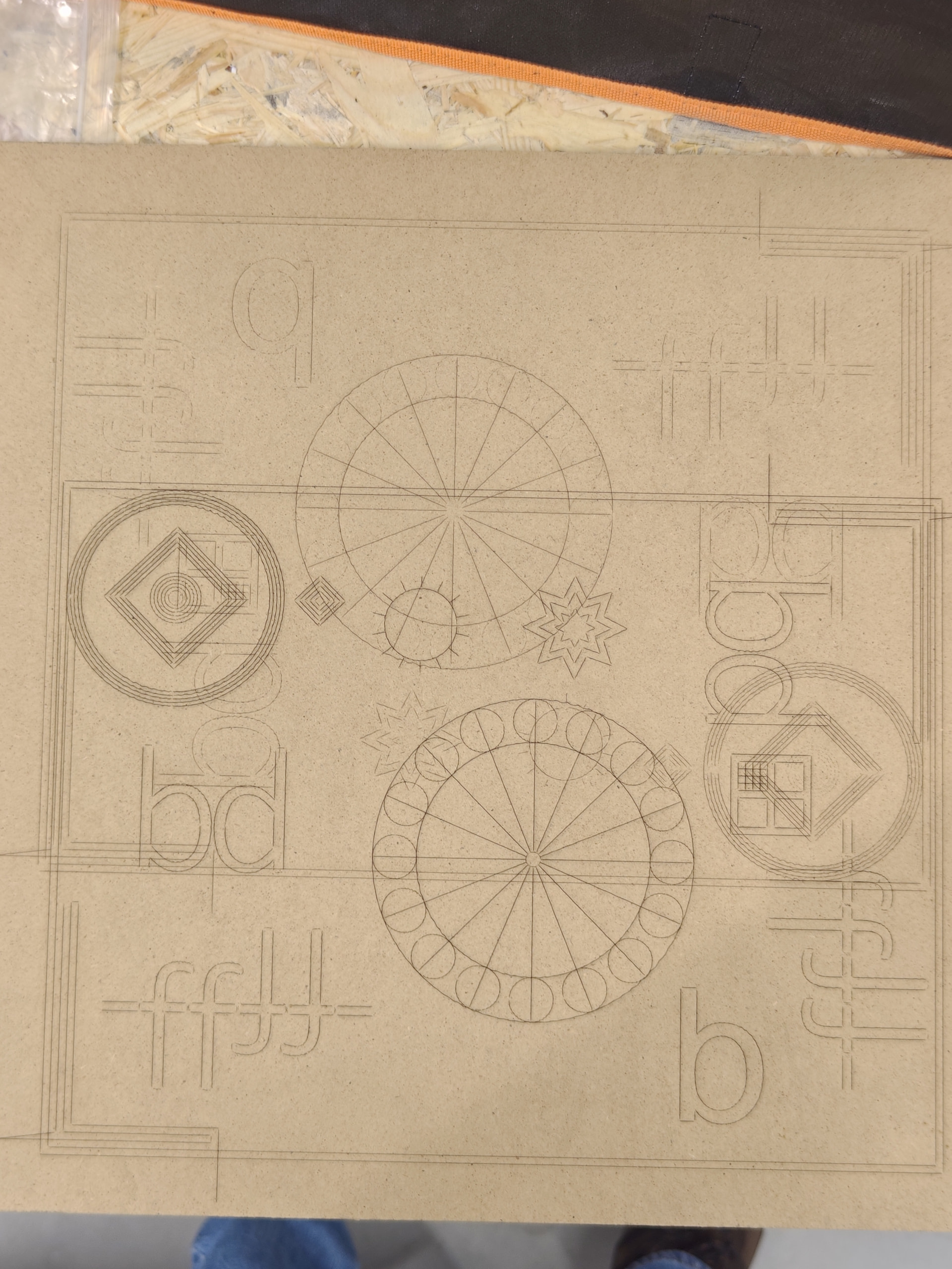

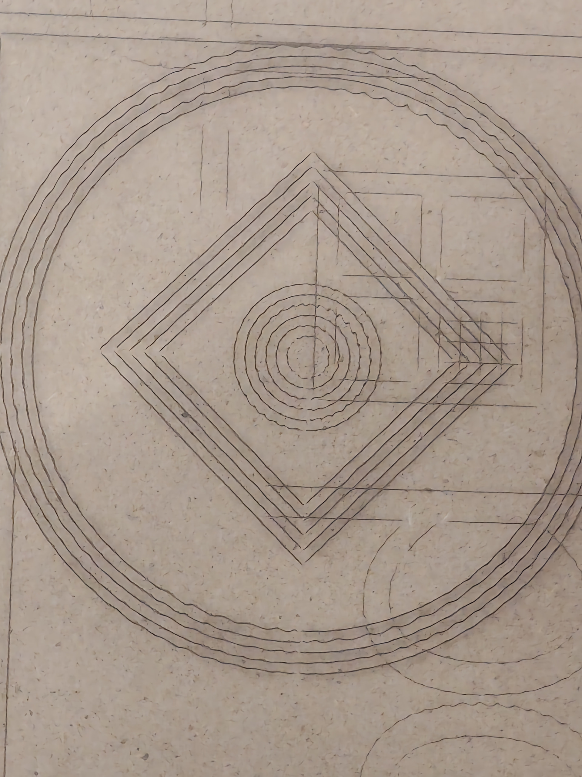

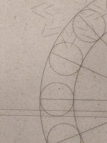

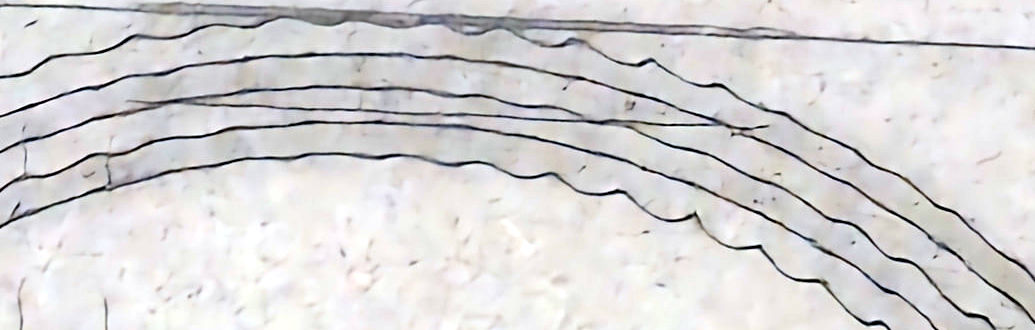

Hi all, I am novice in laser engraving (but I have nice experience with 3d printers) but can’t figure out the problem.. I have fuzzy lines on y Acmer P2. Now it has long frame (800x420 mm) and actually I don’t know were this problem or not with usual 420x400 frame. I did grungetest and I don’t know what to do next. I’ve already tightened all screws and belts. All the same. And result is suimilar on 20000, 15000, 10000 and 6000 mm/min

Yes, all belts and pulleys are in good condition ( laser is almost new, maybe 20-30 working hours). I dont test a voltage, but manufacturer didn’t mention anything about PSU change (it’s official upgrade part). But as I understand testing right, my problems are with X axis (420mm)? Or not? on photos X - right left, and Y - up down
Although that size puts the additional length in the X axis, the machine description and expansion kit description show it in the Y axis, which would account for the oscillations in that direction:
In addition to Y axis belt tension and anchoring …
  • Make sure the laser head cannot move in its mount; the locking lever may need adjustment to properly secure the head.
  • Some folks have found stripped screw threads in the head mounting bracket that will allow some motion, so check those for proper installation.
  • Make sure the bearing followers on the Y axis rails cannot wiggle and their brackets supporting the gantry are secure.
Because the oscillations are fairly sharp, my guess is that the head is loose or the gantry can wiggle. If that’s due to an assembly mistake / oversight, the cause may be buried deep inside the machinery where you can’t see it from the outside.
Don’t be afraid to take things apart to verify what’s going on inside, but take plenty of pictures to eliminate questions when you rebuild it. :grin:

Yeah I already checked laser head and tighten it before, did this again today and sliced M3 threads :slight_smile: but with new m4 its the same story… After that I changed rail bearing for X axis because with hand moving it seemed a little bit “steppy” for me. But it’s the same vobbling again.. I think I try to return short Y axes back next to see the result, but it takes some time. But without belts bearing on Y move nice.

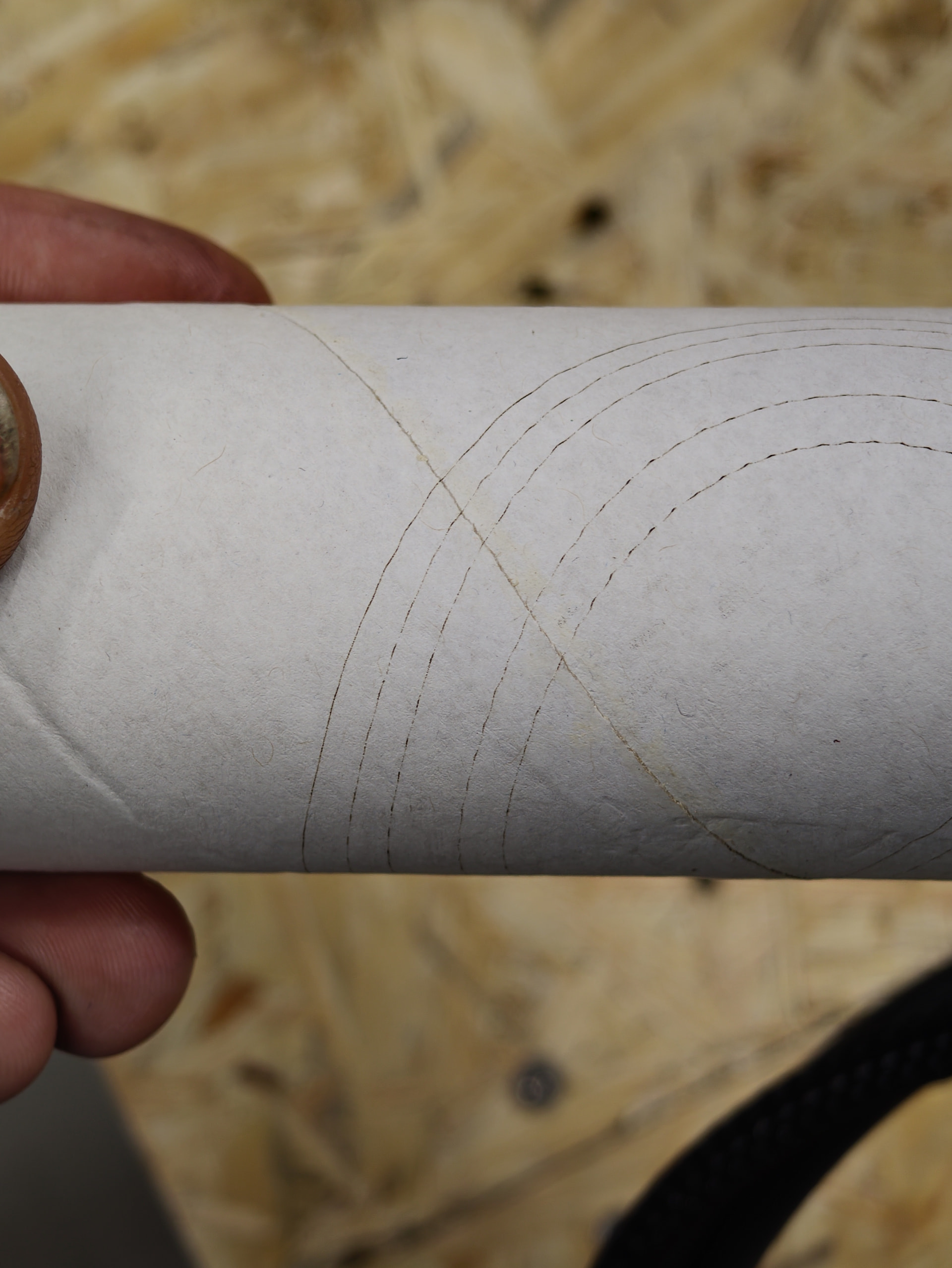

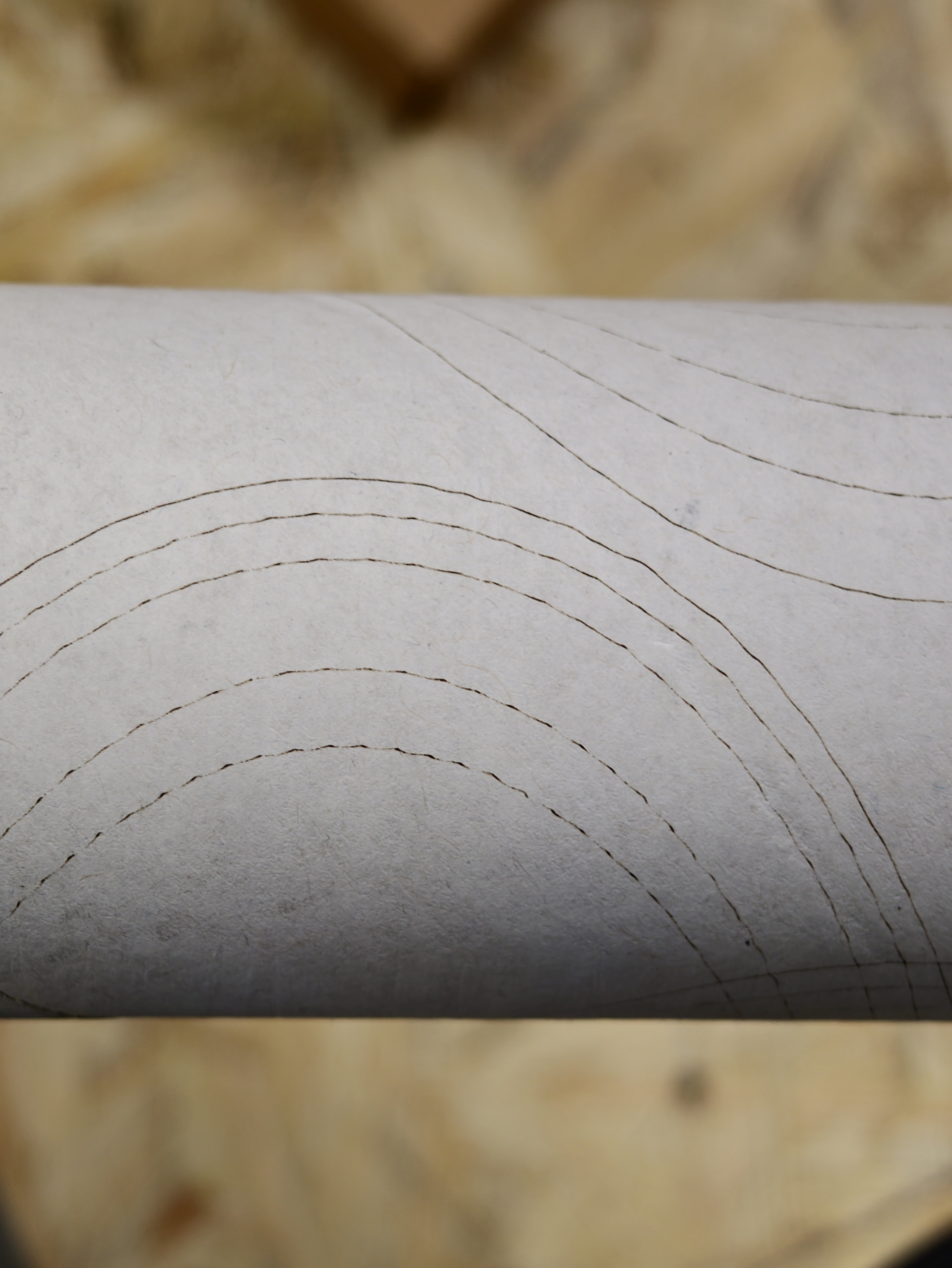

Tried to use rotation Y axis - and I still can feel a vibration in X by hand (even when there is no laser module in head. When I use rotation instead of X axis (or just take out stepper motor cable for any axis) there are vibrations on Y also. I can’t notice any visible vibrations on Rotary tool but its all rubber and I have nothing round now to test marking on high speed.. So, right now i can see two variants - if there will be vibrations on Rotary also, - so the problem can be in power/motherboard, and if not - problems with 2 steppers (low chances as I think?) orI don’t know what else it can be😂.

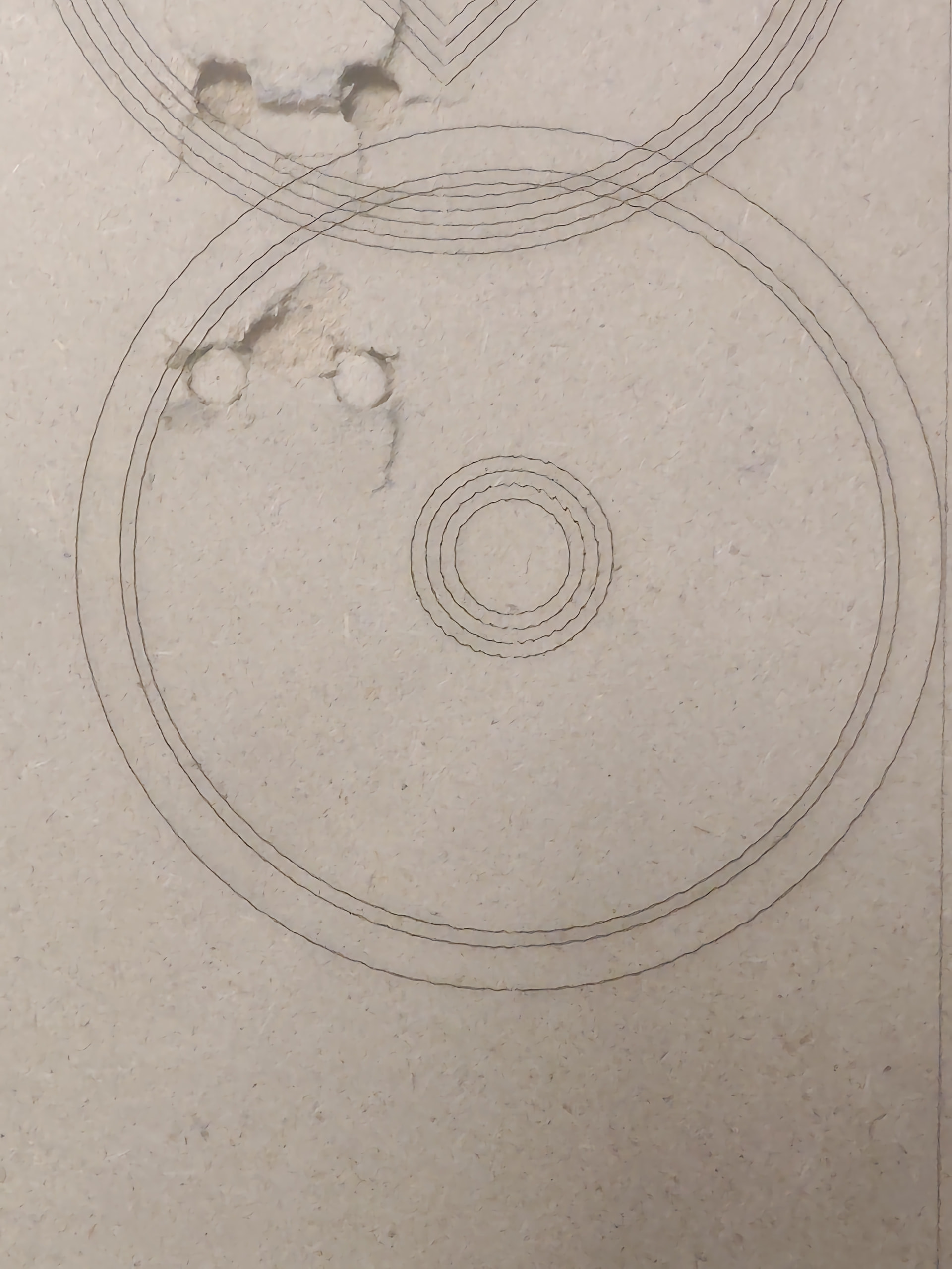

And a little notice. If I do some circles series, firs one is much better than others (it still has some vaves, but not so strong)
Some rotation attempts, and as I understand there are still vibrations on both axis?
