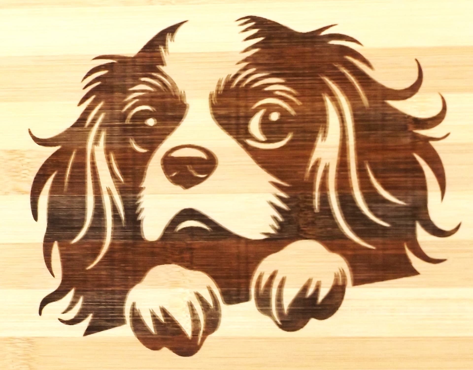

Fuzzy image despite overscan settings
Hi. I had a problem with double images and found out about the overscan settings and sorted that. But now, as you can see above, the left and right edges are fine, but the middle section is still giving double imaging. I am only a newbie to this so am completely at a loss. Its a Creality Falcom 5w

For now, working without being able to see your settings, it would seem most likely that you have mechanical slop in the system.
If you turn your picture 90 degrees, does the problem follow the rotation or does it stay with the x axis?
It never hurts to slow down the laser while you are having problems.
Does the source have this? I would think these peaks should line up.. There is also evidence the whole image is off as some edge areas have less density.
If looks off, are you using crosshatch and or bi-directional scan? You can eliminate an offset issue by turning bi-directional scan off. The job takes twice as long, but it might help you. If you have crosshatch enable, might want to turn it off.

Thank you to everyone who contributed to this. Following the advice seen on another similar question, I I tightened the belt that the laser runs on and it seems to have corrected it. Early days yet, but certainly better than it was. Bit disappointing when I only bought the n thing new in April. Anyway, once again, thanks to you all.
Constant vigilance is required when using high repeating motion machines. A tiny bit of weakness can rapidly become noticeable slop.
