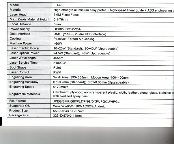

I have the machine set for X-365mm and Y-395mm this is from the manual and called working area, the motion area is 400 x400mm.
My one problem is do I have the proper firmware installed as I have no idea how to look for GRBL Firmware.

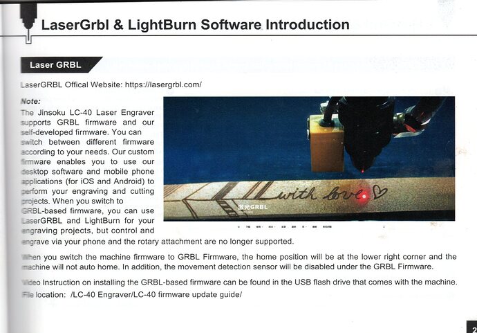

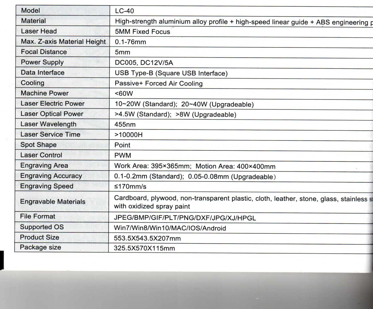

here is the manual specs and
here is the manual.

Is this indicating negative numbers? Or are you saying X is 365mm and Y is 395mm? If the latter that’s fine. I thought you were saying that these were meant to be negative coordinates. One note is that you may want to confirm that 365mm is meant to be on the X rather than the Y. It’s ambiguous how it’s listed in the specs so it could be the other way.
One thing I didn’t realize is that your machine homes to the lower-right. That’s quite unusual.
Can you do “Get Position” in Move window at every corner and record what those coordinates for each corner and report back?

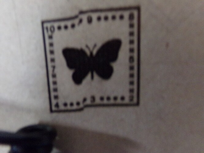

I called Sainsmart and now they think the problem is the power supply, now I will admit it had crossed my mind so I reached over and grabbed it and I let go like fast it was hot and the plastic was a bit soft there is no idea when they can ship a newer supply out. Not wanting to wait I ordered a new Atomstack S10 Pro and it works.
 ![Butter fly](https://forum.lightburnsoftware.com/uploads/default/original/3X/2/d/2d8708559c990b1d4f065c520a8ef08463df0778.jpeg)
I am so happy.
