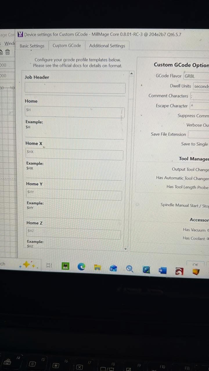

Genmitsu 4040 pro max, 710w spindle. I have the spindle and vacuum connected to a imatic relay. Everything worked the last time I used it a week ago. This time while processing a job, the spindle and vacuum did not come on. All wiring is correct. The spindle and vacuum work independently of the relay box. I think I have to put a value in gcode. Am I correct?

What do I do here?
We need to see first if MillMage is outputting spindle commands. Create a small rectangle profile and set up everything including tooling. Now do a save GCode to a text file. Then attach that .nc file to your Reply.

I sort of understand. But don’t know where I’m supposed to put that info. Also the toggles to the right (cut off by wonderful iPhone) I assume need to be on. But waiting for specific instruction.
