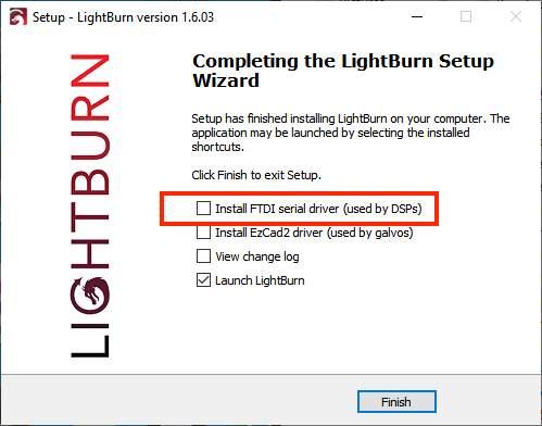

Okay Gentlemen, I have my UV laser working, my Co2 refuses to be set up again on the new computer and Lightburn, getting message " laser busy or working" it is not. Just no communications either by USB or cat 6. I know there is a setting wrong somewhere because is was working without fail.
If anyone can assist me how to use USB flash drive to run the co2 it would be helpful
Thank you
Bob
Upon installing LightBurn on your new computer, did you check this box to install the FTDI drivers? If not, simply reinstall LightBurn and check this box:
Is your Windows computer assigning a COM port to your C02laser when it’s connected via USB and powered on? You should be able to review your device manager to confirm.
Sorry Jess for my slow reply I installed all of these because I have a Commarker UV and an Omtech AF2028 80. tried the USB and Lightburn did not see the Rudia controller. Have not tried again I will tomorrow, Must be up early for my day job.
Thank you, Your response is appreciated, Bob
