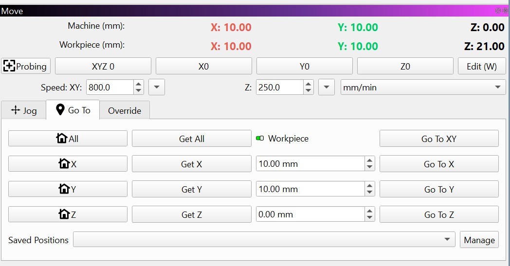

GoTo Not Working
On the Move tab/GoTo tab:
Whether I manually enter or select from my list makes no difference. When entering any number besides zero in the coordinate box and clicking on GoTo button the box is reset to zero and the head moves to the zero location. The Z axis as never worked. In previous versions the X and Y did work.
I’m running the 8.01 RC-03 version.
Thanks, Mark

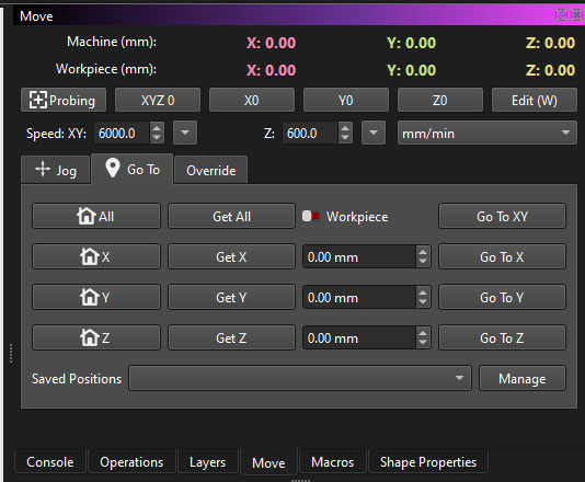

This is the initial position…
When I enter any value in the x or y box and then click Go To for that box the head will go to 0 if not at zero.

Here is what happens
Jog both X, Y to 10
?<Idle|MPos:0.000,0.000,0.000|FS:0,0|Ov:100,100,100>
Starting stream
?<Run|MPos:9.983,9.983,0.000|FS:0,0>
[MSG:Pgm End]
Stream completed in 0:01
?<Idle|MPos:10.000,10.000,0.000|FS:0,0>
After click of Go To XY button
Starting stream
Stream completed in 0:00
?<Idle|MPos:0.000,0.000,0.000|FS:0,0>

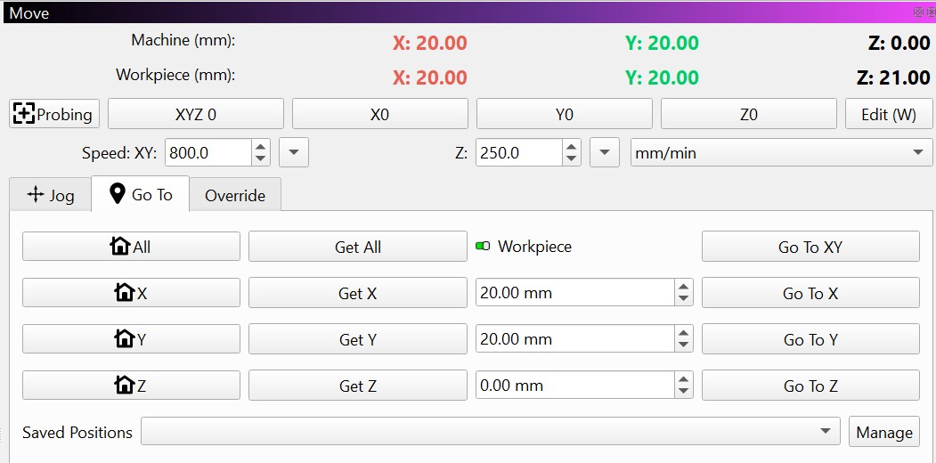

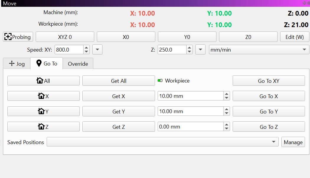

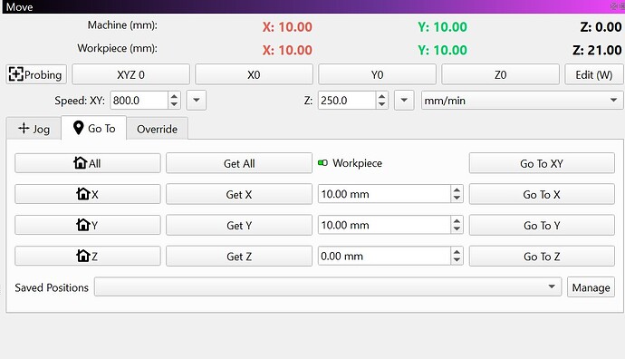

I Homed my machine, then entered 10mm in X and Y boxes. I clicked the GoTo XY button and I get this screen:
I then Homed the machine again and Jogged 10mm in both X and Y, and this screen is the result:
Lastly, while viewing the last screen above, I clicked on the Go To XY button. There was no change in the display.

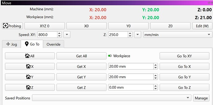

  1. Do you have any offset in the G54 parameter?
  2. In your second image, I see 20mm instead of 10mm. Why is that 20 there?
  3. If I did not duplicate your steps accurately, let me know where I deviated.
  4. Duplicate my steps and see if you get the same results as I did.
I am not contesting or disputing what you are getting. We just need to work together to figure out why the difference. Could be procedure, or it could be a laser that does not play nice. :grin:

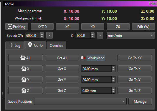

That is the manual entry just before clicking on the Go To.
After the click the box resets to 0,0 and sends the head to 0,0
Mine does not do that…

First is to Jog to 10, 10
Second is set X and Y to the values of 20, 20
Third is to click Go To XY
What happens then:
The boxes are reset to 0, 0
Then the head moves to 0,0
The 20, 20 is lost in the replacement
Yes, I understand completely. That reset is the part I think should not be happening, but I have no idea what causes it, meaning no idea how to fix it.
