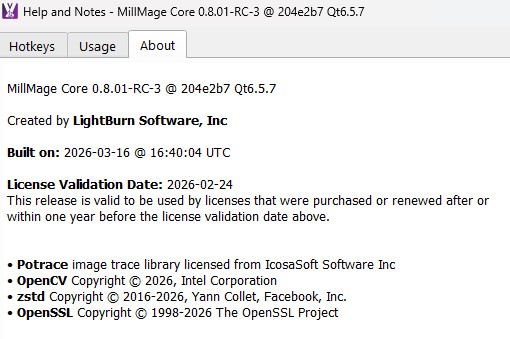

so i downloaded the 8.0 version and installed it and checked the ver (see screen shot of version) 8.00
, then i closed MM and reopened it and checked the version( see screen shot of version) 8.01. i did this 2 two time’s with same results??
They are in 2 different folders, but your shortcut is pointing to the Release Candidate.

You will see the release information on the title bar as well. When checking for updates from the released version, I see the following.
I note the title bar from a few images you posted showing you were running the Release Candidate version.
“RC” stands for Release Candidate, which is a pre-release or public beta version.
