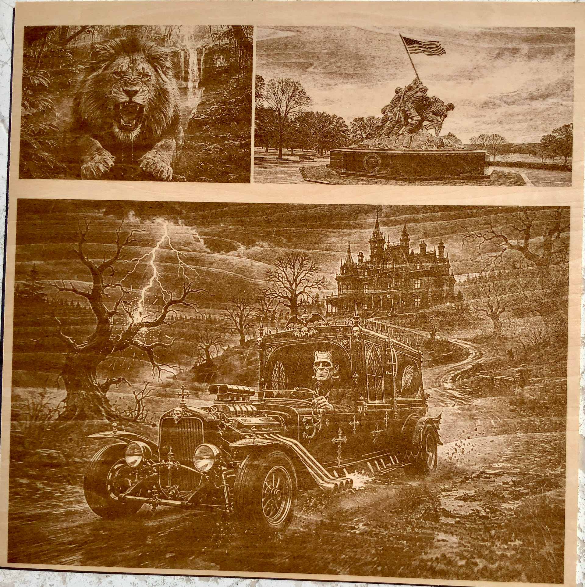

I too don’t like the grain on the basswood. One of the things I love about woodworking is finding wood with crazy grain, but in this case of engraving where the grain interferes with the effect I’m trying to get, I wish for the most bland/boring grain possible.
First I am amazed at the coloration of the stainless give. I understand the process, but it is way above my capabilities. I love the fact you can see the rain. That’s one thing I am trying to bring out on wood.
Yes the grain issue is always an issue. Trying to find a nice clean piece is next to impossible, especially in the cheap plywoods, plus you need a light colored wood as well.
Painting the surface isn’t going to work, because you are basically marking almost all of the surface.
MDF isn’t the answer either. There isn’t the grain, but you have all the different sawdust particles and glue to deal with.
I also found out in this process. Grain direction matters as well. Engrave with the grain give you one result, and going across grain looks really bad, plus 254 DPI vs. 317DPI is another whole ball game. I am trying to get the higher DPI in order to get a blacker burn. Not succeeding currently, but close.

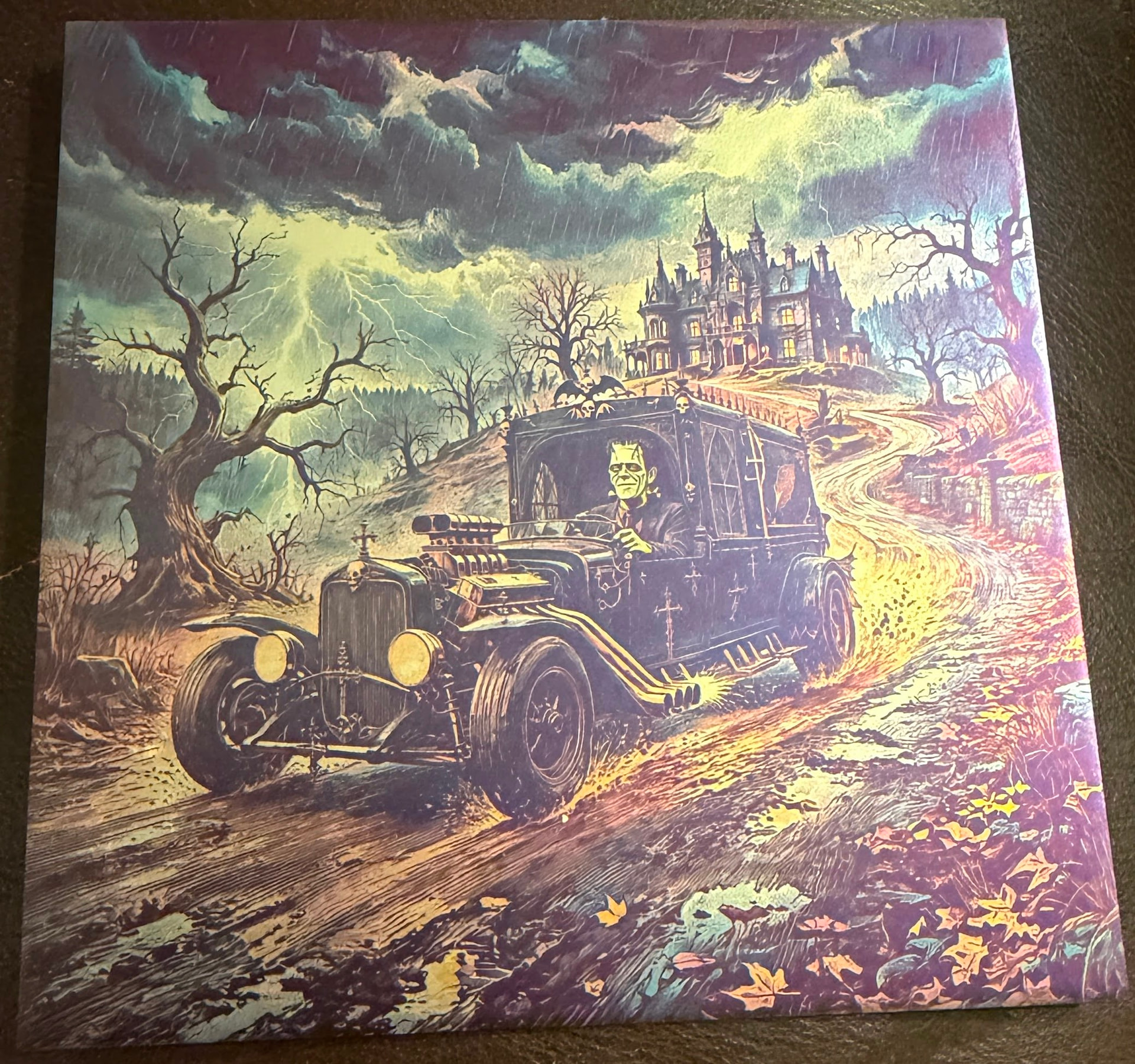

Here’s my second attempt on the halloween image, now on titanium. I adjusted the separation to get more detail in the tree and the car. It’s slightly lighter overall. It also got a bit more green in the driver’s face and the ground in front of the house. The colors are a bit warmer and richer in real life. For easy comparison, I included the original (mildly modified from Jay’s version by Nano Banana 2).

Birch ply is a has a harder veneered surface, and a little getter grain. The grain pattern and a little whiter, but grain remains a problem, but it does burn darker. I am playing around with that now, and I think I am getting ther slowly but sure.
The big problem with plywood is the manufacturing process. The peel the log to make the veneer and that compound the grain issue. Quality ply (furniture grade) is the log is sliced and then edge glued. That makes for pretty repeating pattern in the sheet. That’ May or may not be good, and depends on the species. Maple is probable the best for whiteness and grain, but the glue that holds the ply together might be an issue. Some glues don’t cut well with a diode laser.

Thickness of the metal is only a factor if the metal isn’t flat enough. I use 1mm which mostly works fine. I found one supplier who tends to produce flatter sheets, plus I think the colors are better on their exact GR2 alloy. So I’ve contacted them about bulk pricing.

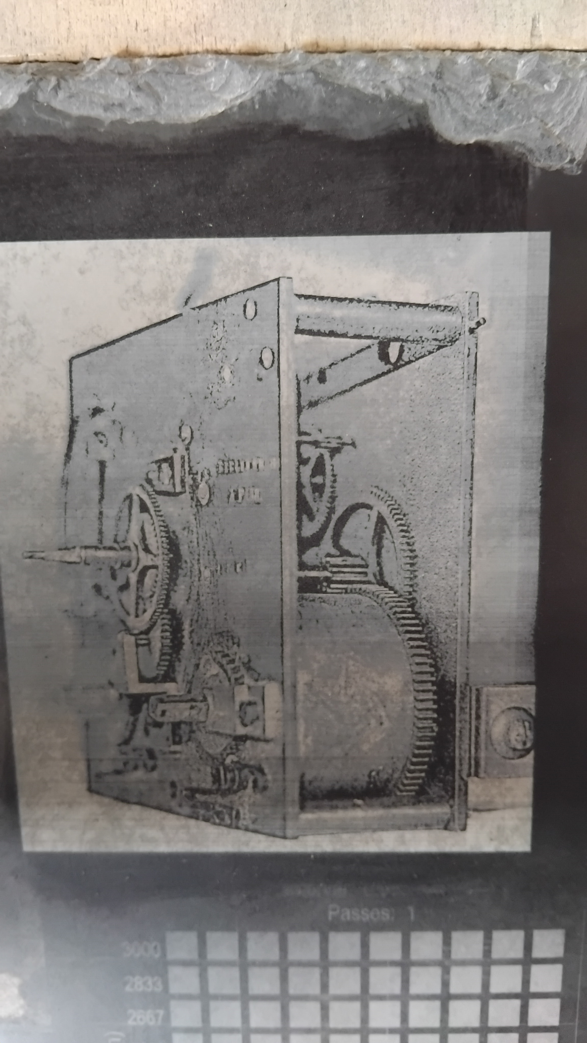

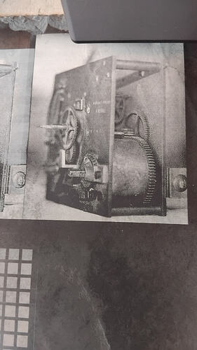

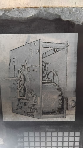

I was working on the photographs yesterday with processing adjustments I thought were going to improve things..bad idea, Suddenly got the urge to lash on the 2w 1064nm. Bit like searching around in the golf bag for an alternative to the five iron…and pulling out a snooker cue! Couldn’t remember a single setting for slate.
Got this after three attempts.
Greyscale, 50%, 2000mm/m, 300dpi, 100mm(H) and if it wasn’t for the high ‘sharpen’ there wouldn’t be much detail so I’m currently running a dither version just to compare.
Have to figure out how to calibrate the photo, the processing and the LB image settings because it’s far from photo image quality.

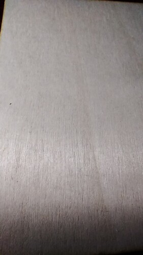

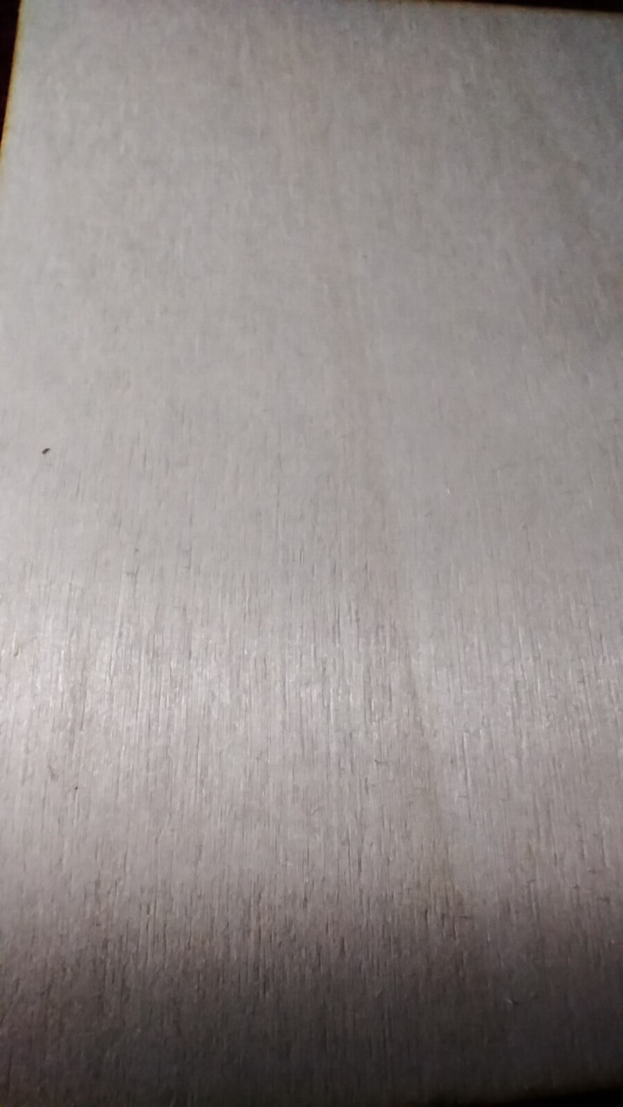

I tried to get the ply-type for those coasters but the bag has no product details. I do know they were got on a website called Timu.
I tried to photo the grain but even in macro it’s very uniform..this is as close as the lenses could be.

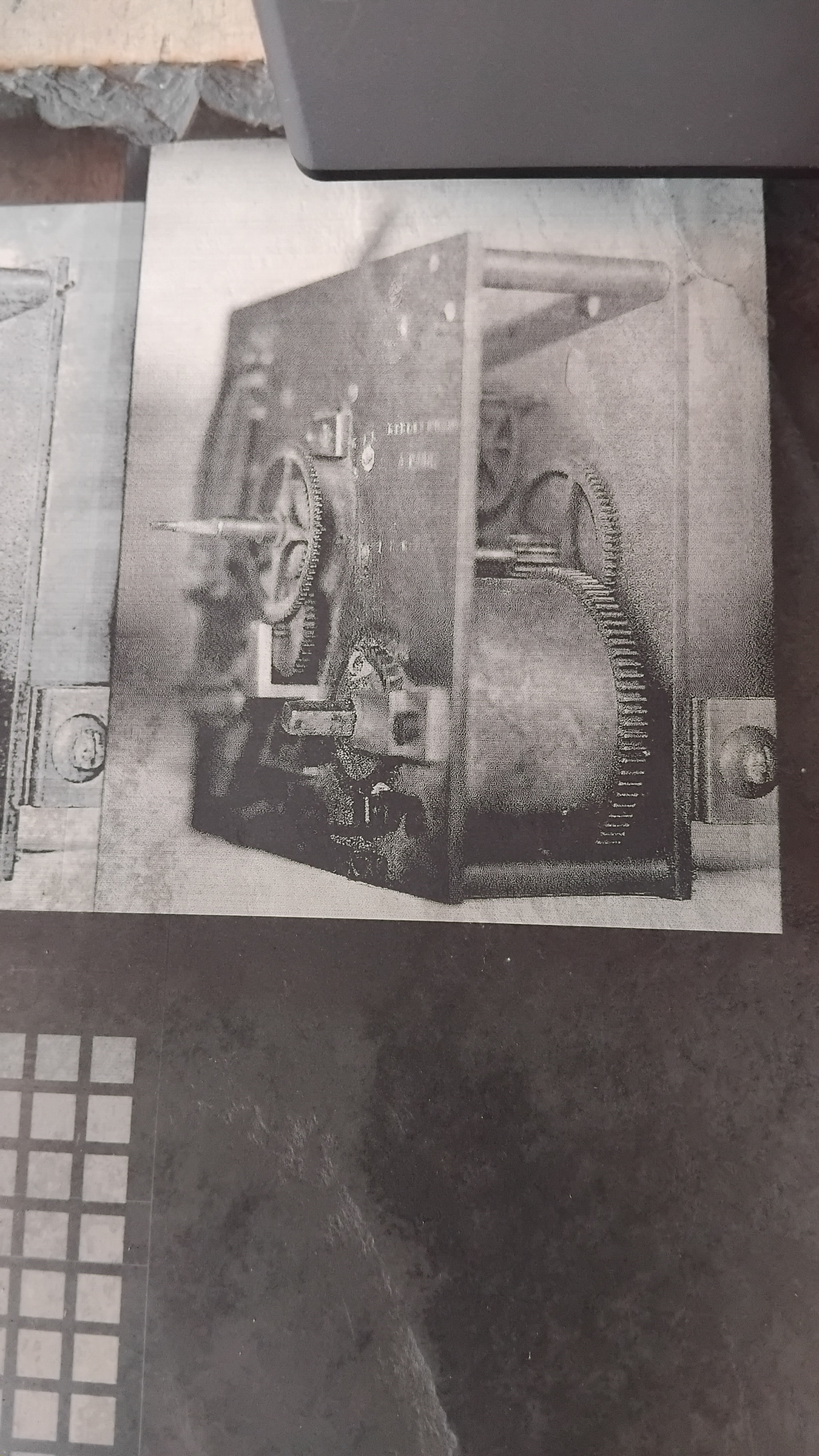

Jarvis, all settings as above.
It ran off the slate a little but it’s better..ish.

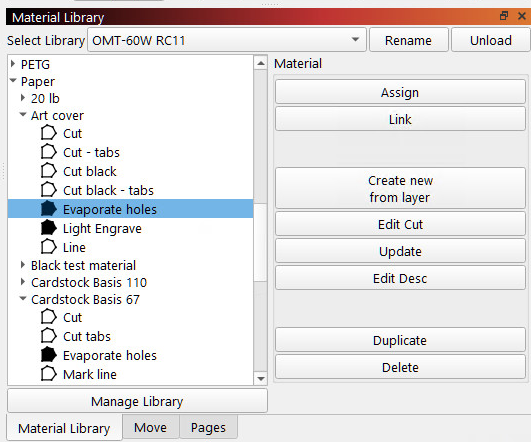

I depend on my Material Library:
Yeah, I’m outsourcing my memory, but sometimes a man’s gotta do what a man’s gotta do. :grin:

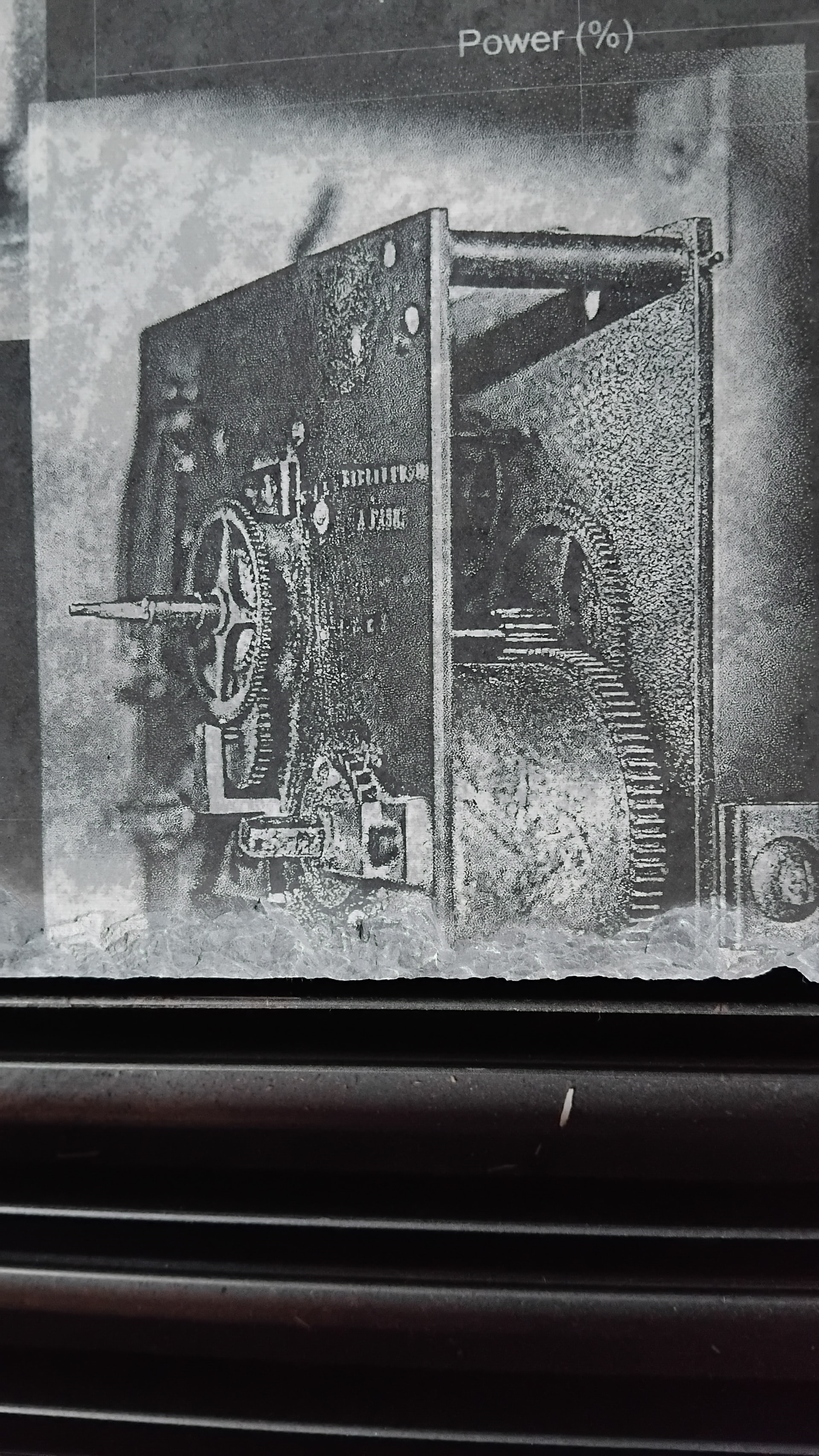

Today’s Jarvis version.
I have it burning dark and good settings. I have a tremendous amount of detail now.
Still on basswood, but look at all the grain. The grading going through the sky is kind of interesting, make it look windy, but the rest is yuck.
It looks tan but it is really gray.
