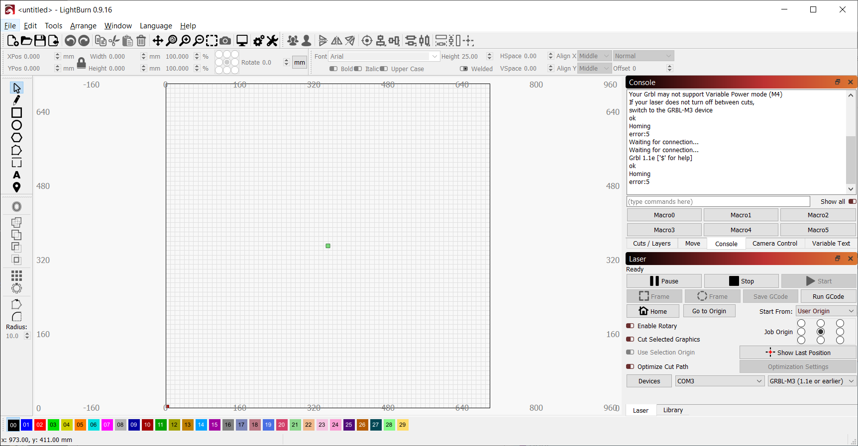

So my laser has been working awesome. I moved it into the office and now it won’t connect. I’ve tried both GRBL and GRBL M3. It says “error Homing”. Any help will be appreciated.
Here are my settings
$0=10 $1=25 $2=0 $3=0 $4=0 $5=0 $6=0 $10=0 $11=0.020 $12=0.020 $13=0 $20=0 $21=0 $22=0 $23=3 $24=25.000 $25=500.000 $26=250 $27=1.000 $30=1000 $31=0 $32=1 $100=80.000 $101=80.000 $102=80.000 $110=5000.000 $111=5000.000 $112=10000.000 $120=250.000 $121=250.000 $122=250.000 $130=500.000 $131=500.000 $132=500.000
It connected just fine - The text saying “GRBL 1.1e”, “ok”, and “error:5” all came from your controller.
It said hi, told you who it was, said ‘ok’ to wait for a command, then LightBurn issued the automatic homing command (you’ve enabled Auto-home on startup). The controller saying “error:5” means you told it to home, but don’t have that enabled in your settings. ($22=0 means homing is disabled).

And what exactly would you be Starting or Framing? Your design is empty. :slight_smile:
