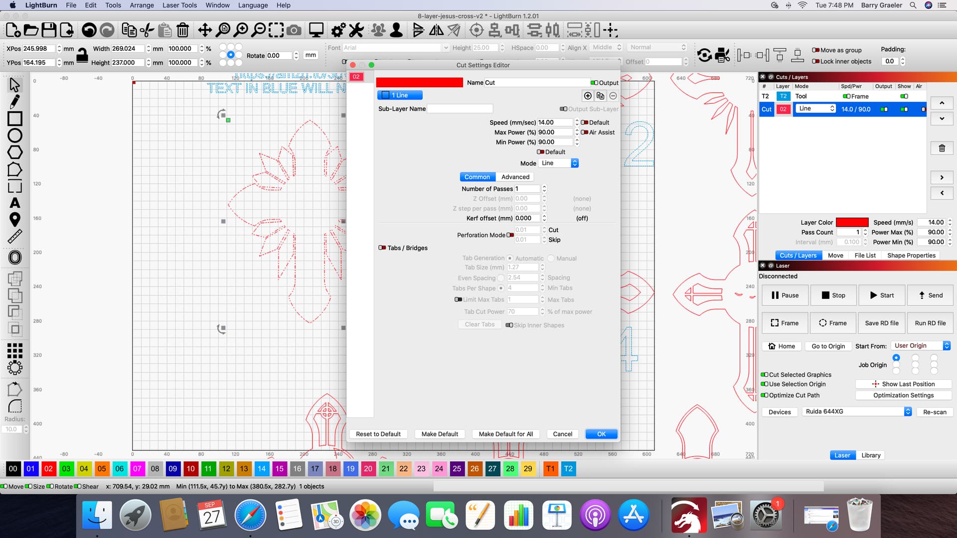

I purchased an 8 layer cross from a developer. Layers 2 thru 7 burn at the correct dimensions, 237mm high and 190mm wide. Layers one and eight burn to the correct height but not the width.Layer 8 burns to 190mm wide if I change the width in Lightburn to 206mm. Layer one will not burn to 190mm wide no matter what width I input into Lightburn, it always burns to 146mm wide. The developer of the eight layer cross has worked extensively with me to try and resolve the problem. I have deleted the file from the computer, as well as Lightburn and the Ruida controller. I downloaded the 8 layer cross again and loaded it into the computer, Lightburn and the Ruida controller and still get the same results. Everything works perfectly except layer one and eight. Also, all the other files I have downloaded work perfectly.
Anyone have any idea what I might be doing wrong? I am using a Thunder Laser, Nova 24, 60 watt with Lightburn version 1.2.01 on a Mac with OS Catalina version 10.15.7.

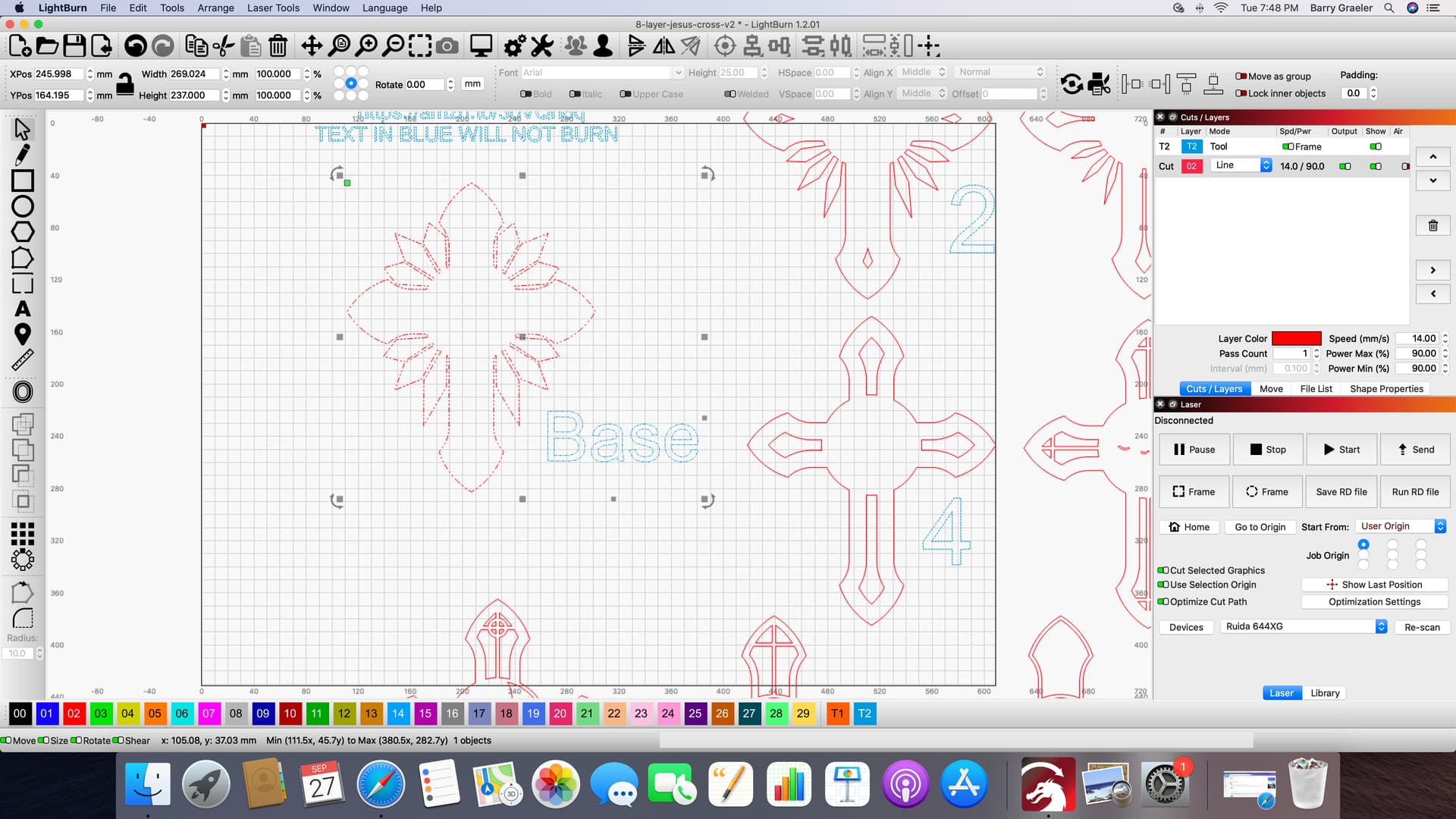

No, I have not completely cleared out the Ruida Controller, only the 8 layer cross file since the Controller is only about 15% full. I have attached a screen shot of the layer settings as you requested as well as a screenshot of the LightBurn worktable showing the dimensions of layer 1 which is the Base setting. All layers are suppose to be the same dimensions, 237mm high and 190mm wide. Layer 1 shows dimensions of 237mm high by 269mm wide. I can change the width in LightBurn to 190mmm wide but it cuts at 146mm wide. Also, I have attached a screenshot of layer 8 which now cuts correctly, laid on top of layer 1 to show the disparity between the two layers. They both cut to the correct height of 237mm but layer 1 still cuts to 146mm wide.
How are you determining the dimensions of each layer? Seems to me there are extraneous objects in each “layer”. If you take into account the various objects each layer would be a different dimension.

The dimensions of each layer are the same, 237mm tall by 190mm wide. It even mentions that in the video. According to the Developer all you have to do is separate each layer and select “Cut Selected Graphics” and each layer will burn to 237mm by 190mm.

From what you’ve said I think there’s a clue in that each layer should be the same size.
From what you’re showing in the selection it seems to me that perhaps you’re not to include the identification markers in the layer. For example, “Base” is situated wide of the upper and lower bounds of the cross. It looks like in the other layers the id marker is close to or within the bounds of the cross shape.
This could explain why scaling the shapes would lead to distorted output.
I suggest further breaking down the layer to exclude the ID markers to see if that leads to the dimensions you expect.
